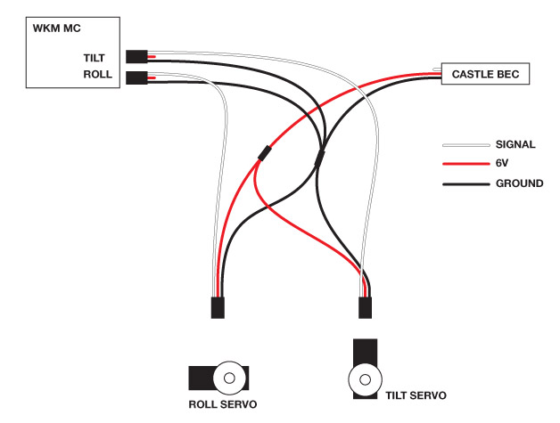

Could anyone who has their AV130/gimbal connected up to the gimbal outputs on their wkm please have a look at my diagram below and confirm that i've got the connections correct?
