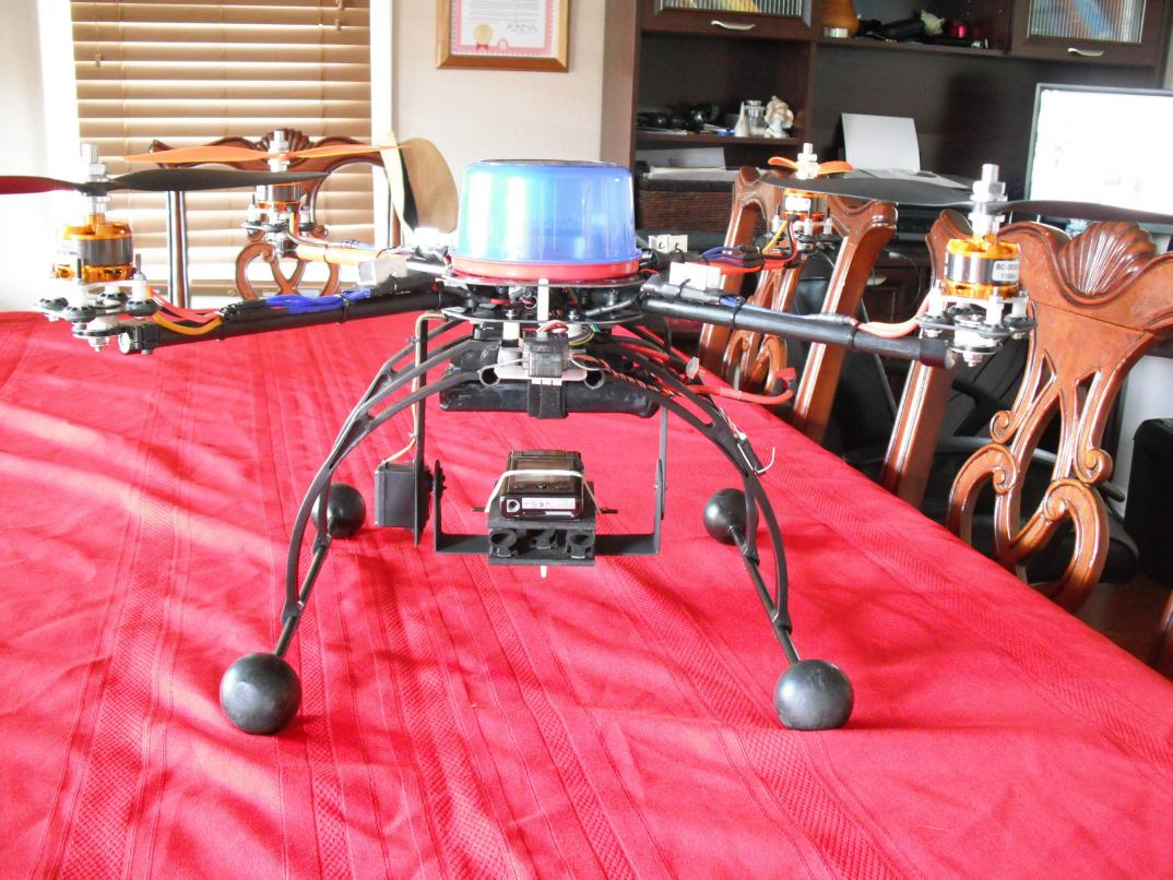

I am running the Naza+GPS on a F450 frame. Because of GPS/GoPro interference, I added a metal leg to the frame with the GoPro underneath. This leg frame was from the Walkera MX 400 quad.
I currently have APC 9x4.7 props installed, motors are Turnigy D2830/11 1100kv and ESCs are Hobbywing Flyfun 30A. Are the APC 9x4.7 suitable for lifting over 1100g weight? I did a test run and can hover at slightly over half throttle and is maneuver the quad with no problems. After flight, the motors are almost warm and battery. Running 3s 2200 @ 30c getting almost 6 minutes. without the legs, I get almost 10 minutes.
