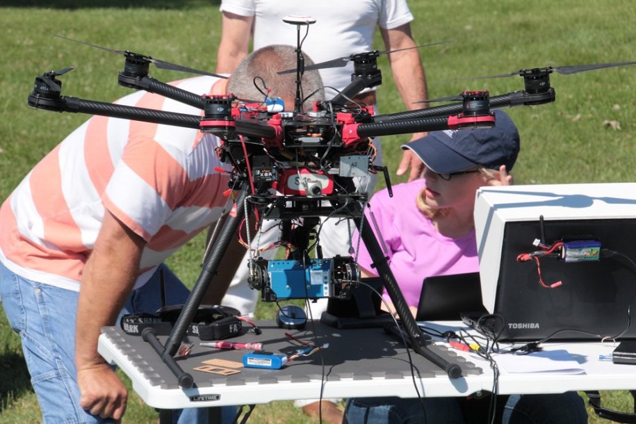

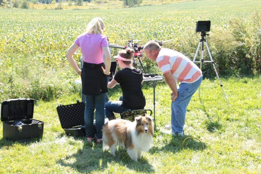

As a result of finding that the PC version of the DJI Ground Station has basically abandoned, I have decided to forge ahead and attempt to work with the Waypoint Mission Planning GUI and see if it can be relied on to create missions the are reliable. We shall see. View attachment 26372 View attachment 26373
