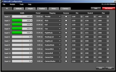

Now I'm using the plus style and the control is JR DSX11 2.4GHz. Now I can control it using hover mode, but it was a little bit toward to the front side when taking off! What should I check? When can I upgrade to cross style? What is the different between the Hover Mode and Cruise Mode?

Eric, you should be able to just select your style in XA Centre, if I remember rightly.
If you read through the threads you will see that many have had issues with the X650 drifting in various directions.
Important is to make sure the thing is absolutely level when you calibrate the AHRS. Make sure using a bubble. or spirit level.
It is equally important to make sure all your motors are perfectly plumb, ie the props are level.
If you have done this and it still drifts significantly it will probabaly be the AHRS at fault which is fairly common.
Mine was unflyable due to drift until I upgraded the firmware in XA Centre.
In hover mode it will level itself when you let the right stick (in mode2) centre.
In manual the resulting attitude from your last command will be held so it will keep going in the commanded direction.
You wont notice your drifting problem in manual.
