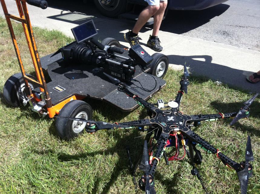

Good advice above...... But in my case I have a S800 clone, i.e., RCT800 with 420 kv motors and 15 x 5 cf props running on parallel 6S - 5000 mah Nanotech batteries. How much airtime will I get if I carry the Red Epic shown on the dolly next to my Hexacopter....... ha. ;-) !!!. :highly_amused:;-) Maybe if I get them to change down to a smaller lens!!!View attachment 13311:highly_amused:
