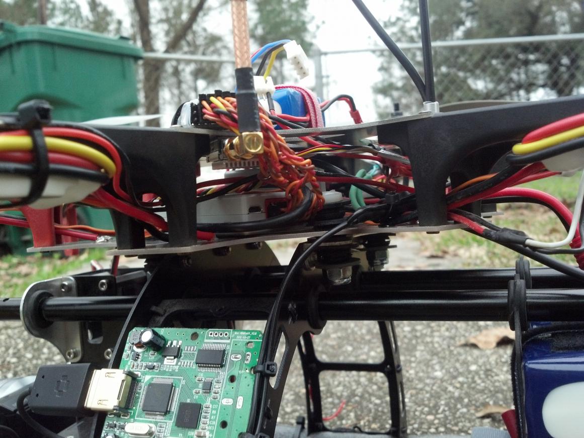

Vibration dampening with F550 and aeroxcraft landing gear/gimbal
Recently I've been trying to dampen the vibrations going to my nex5n to get more clear shots. Went to the local hardware store and got some longer bolts for my landing gear mount, and a bunch of rubber grommets/washers. This is what I came up with so far.. Rubber inbetween the bolt head and upper frame, rubber inbetween the lower F550/upper landing gear, and rubber inbetween the bottom nut and landing gear. Haven't tested it much yet, hopefully today.
