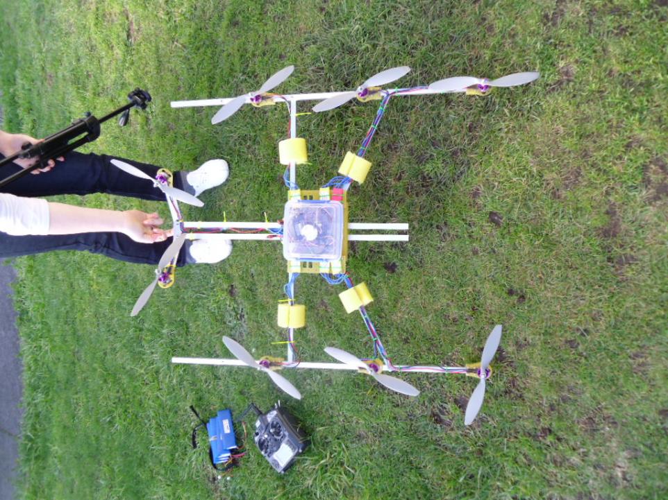

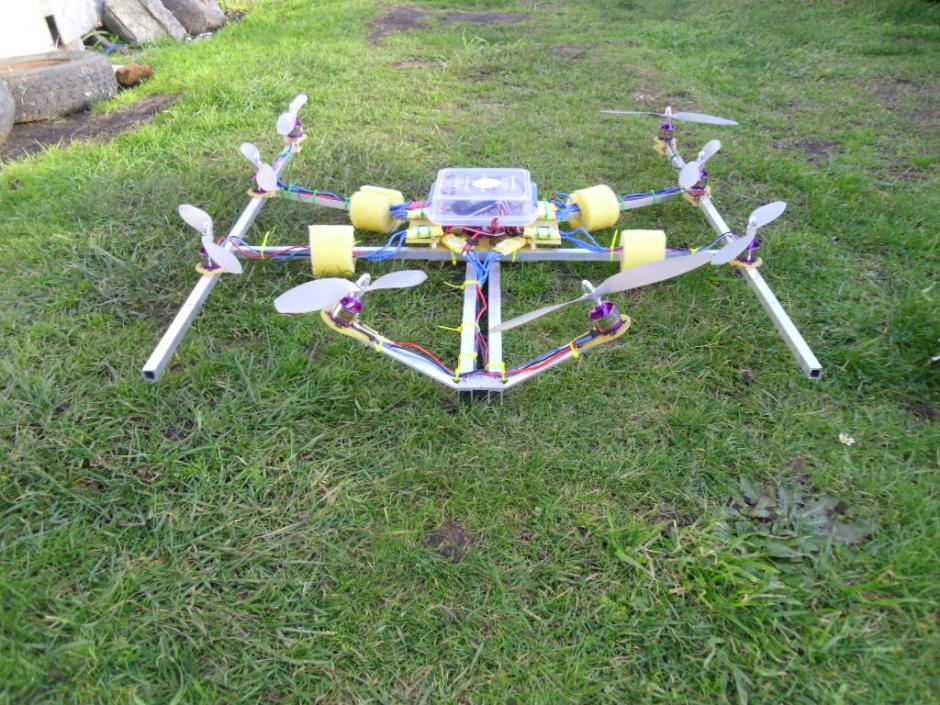

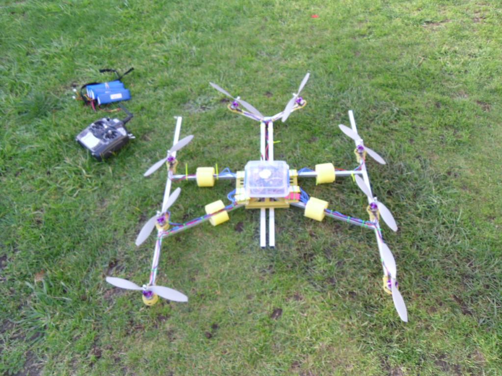

Its a sucess !!!
Completes the trifecta this weekend
8 Props
Vtail Yaw
5 channel control setup on copter control
Airframe weight 2220 grams
8 of RCT 750 motors 10 by 3.8 apc props
4S 5000 lipo (614 grams)
payload - old lipos 911 grams
AUW flying 3745 grams (122.5 oz)
Pics here, vid to come, maiden flight untuned, settings to come
View attachment 529View attachment 530View attachment 531
