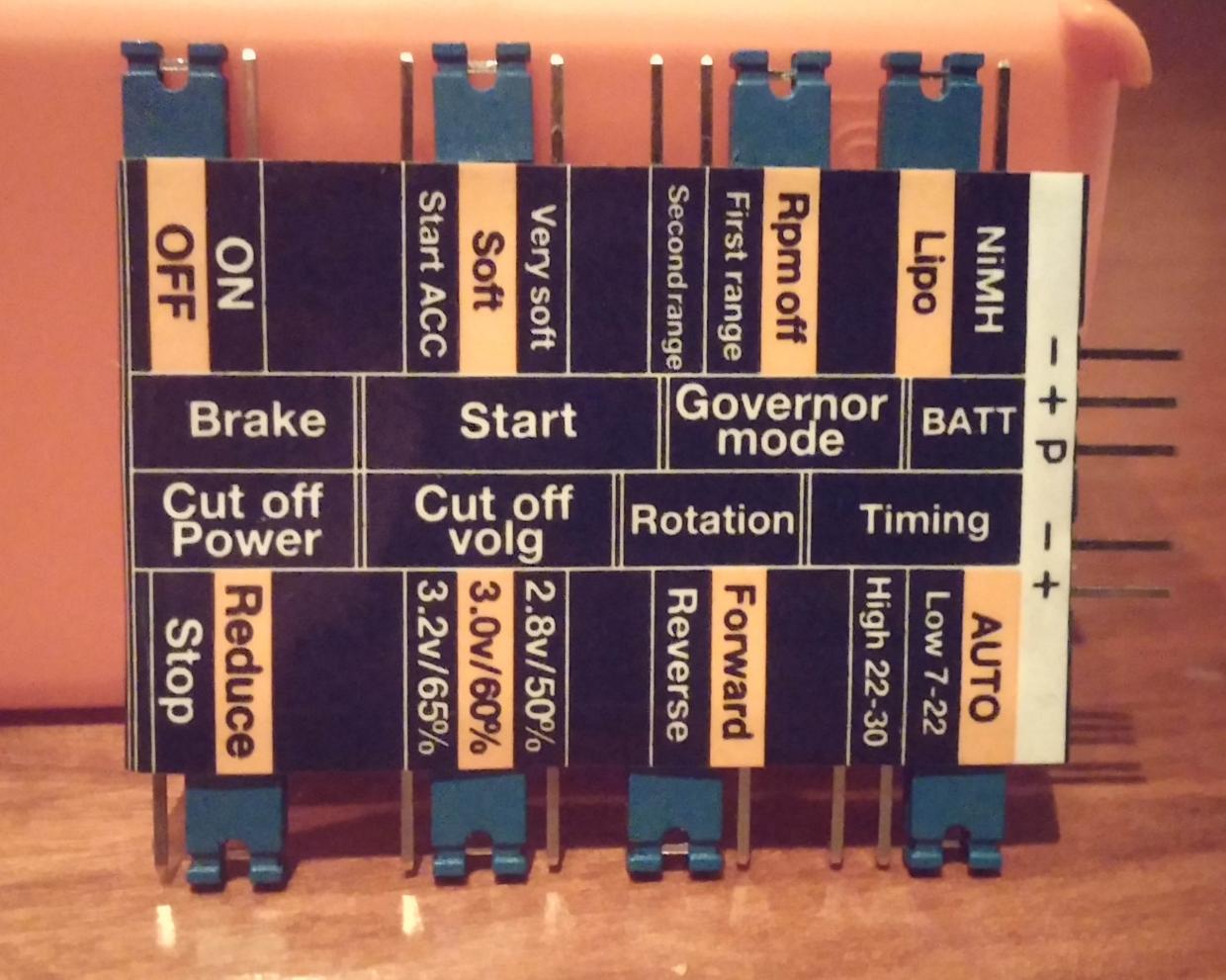

I am using a Tarot T960 with Tmotors 4014-9 400 and a NAZA-M V2 flight controller. Until recently this setup was rock solid and a dream to fly.
But after 20-30 flights with my new motors I experienced some problems which I think is caused by timing issues (motors - esc). See this post:
http://www.multirotorforums.com/showthread.php?22667-Tiger-Motors-4114-9-400-problems
So I switched to 6 new ESCs from Hobbyking:
https://www.hobbyking.com/hobbyking..._BlueSeries_Brushless_Speed_ Controller.html
(Se image for ESC settings)
attachment.php
Now the copter feels unstable when in the air. See the video.
Can this be caused by incopatible ESCs, wrong ESC settings - or can it be something else??
Kjetil

Not certain but I thought I heard a lot of motor "ringing" in that video. If that was the case there are timing issues.
Hi, not an expert but with higher pol motors you should buy a matching set of ESC's why did you not buy the matching T-Motor ESC's that work with your motor?
