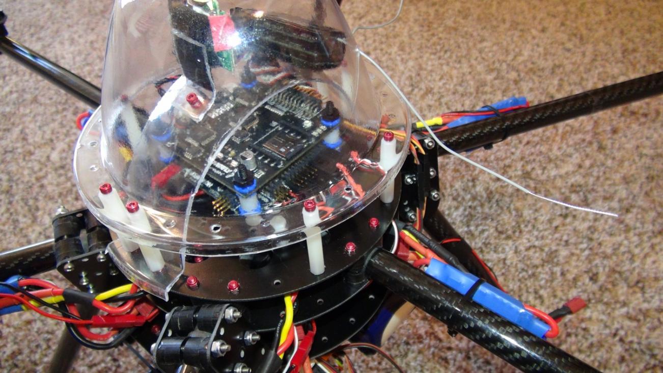

I've been having some issues with my HFly Pro black board with version 4.6 firmware. When I get up to about 10-15 feet off the ground, I get a twitch in the hex that usually drops the left arm and then quickly tries to compensate which makes it very unstable. I've almost crashed a few times, as shown in the attached videos. The sensor diagnostics run through fine. I tried to download a logfile right after the attached movie, and the setup utility says it does, but there is nothing in the file.....
I get the same twitch with and without the GPS board attached and with all levels of main gain. Nothing really seems to help. I've been flying HFPros over the last 2 years or so and I've never had any issue that I couldn't solve. I've replaced the left ESC and motor (the one that seems to drop out), but it still twitches.
Here is my set-up and some pics:

To solve another issue, we stopped recording flight logs on the HoverflyPro. They are only recorded on the HoverflyGPS now. This is why the file is empty. Haven't had a chance to update the setup client to reflect this.
It sounds like you have a power / ESC issue based on the symptoms you described.
