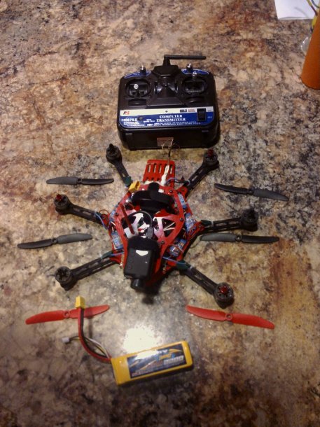

View attachment 24659 Hello everyone here is my build list:
310mm Hobbyking Thorax Limited red version, used 30mm standoffs to fit vertical pin connections
KK2.1.5 with Steveis firmware 1.18s version
Boscam 200mw video Tx/Rx
Emax PM 1806 2300kv motors
Hobbyking 10a Ubec Escs
Mobius "C" wide angle lense V3
Fs-ct6b Tx/Rx
5030 gemfan propellers, red and black
And white/blue leds for visual orientation
Mattmesa
Thanks, something I have learned so far is the difference between a symmetrical Hexacopter and an asymmetrical Hexacopter. The Thorax is definitely asymmetrical and after a Youtube physics lesson I have adjusted the FC mixer editor to match my motor layout and now I will be resetting my P & I settings.
Mattmesa
Finally dialed in my PI settings, now my Hexacopter flies nice and stable. Not that tuning was all that hard, I had to find the time!
ThoraxRacer
Do you happen to have the values to input into mixer editor for the thorax? It really confused me.Sorry NOOB alert!
