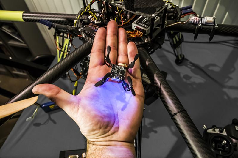

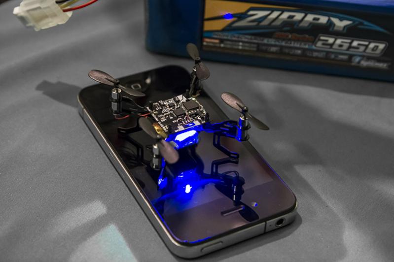

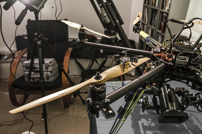

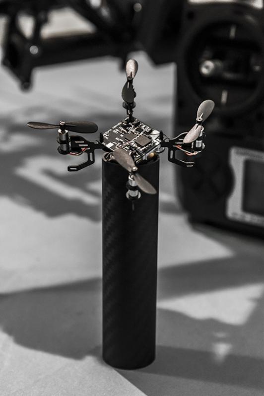

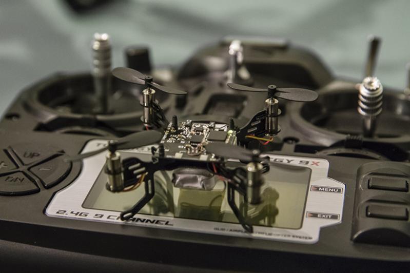

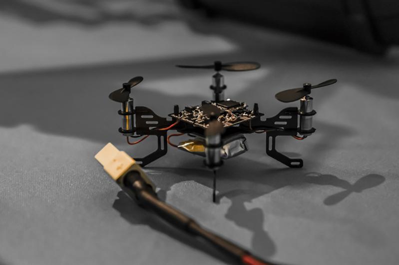

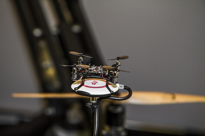

Hi all,
I just show you the last born of my Multi's family ...
The POCKET MULTIWII-X, this little gem has been fully realized (except RX) by a little genius who lives in Europe (Luxembourg), his name ULIX, a crazy kool guy ...
The features of the machine are as follows ...
- Pocket Multiwii-X
- FC Nano multiwii (made by ULIX)
- RX spektrum 0.28gr Sum PPM.
- Battery LIPO 1S 70mA
- Propellers 30mm
- Distance between motor axis 40mm
- Flying time approx 5min
TOTAL WEIGHT IN ORDER to flight with LIPO 1S : 7g
I just let you see the picture of the Baby i also put some video made by the conceptor himself...
Speed test and presentation...
This guy is really an ARTIST and his machine fly very very well and smooth....
I give you some pictures that i' have taken recently with my Cinestar and his baby...:black_eyed:
