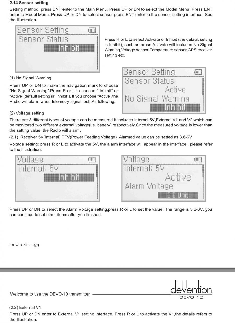

Anyone know how to setup telemetry on a Devo 10 for a Naza F450. I've been reading the manual, but can't figure this out. If someone can make a youtube video on how to do this, it would be much appreciated. I just want to be able to have the Devo vibrate once the lipo runs low.
