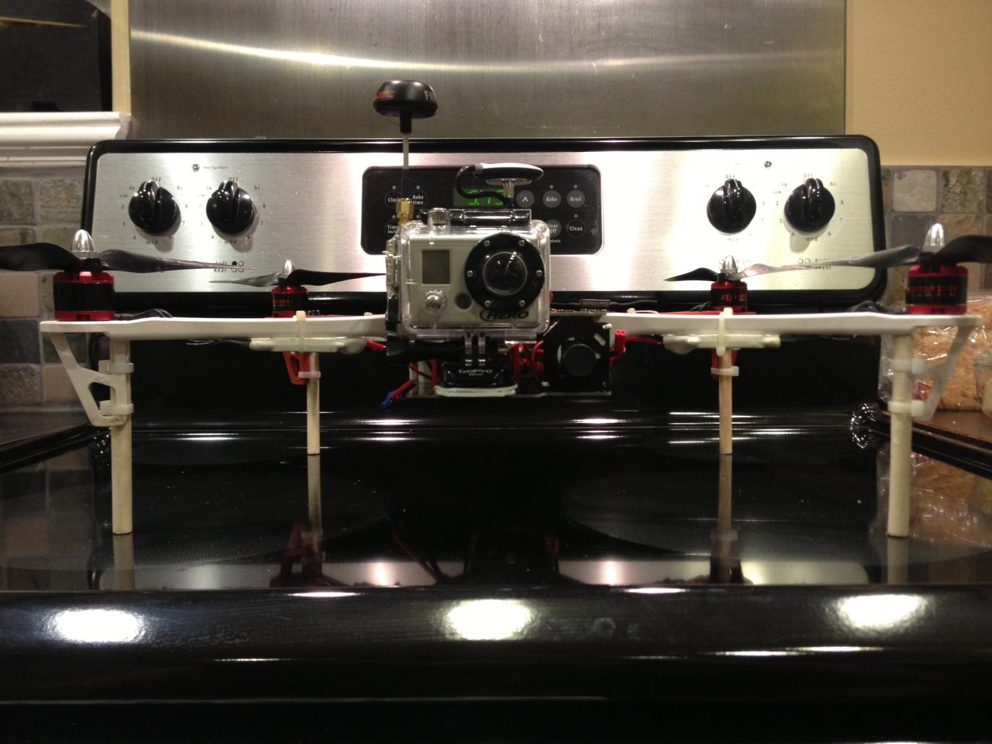

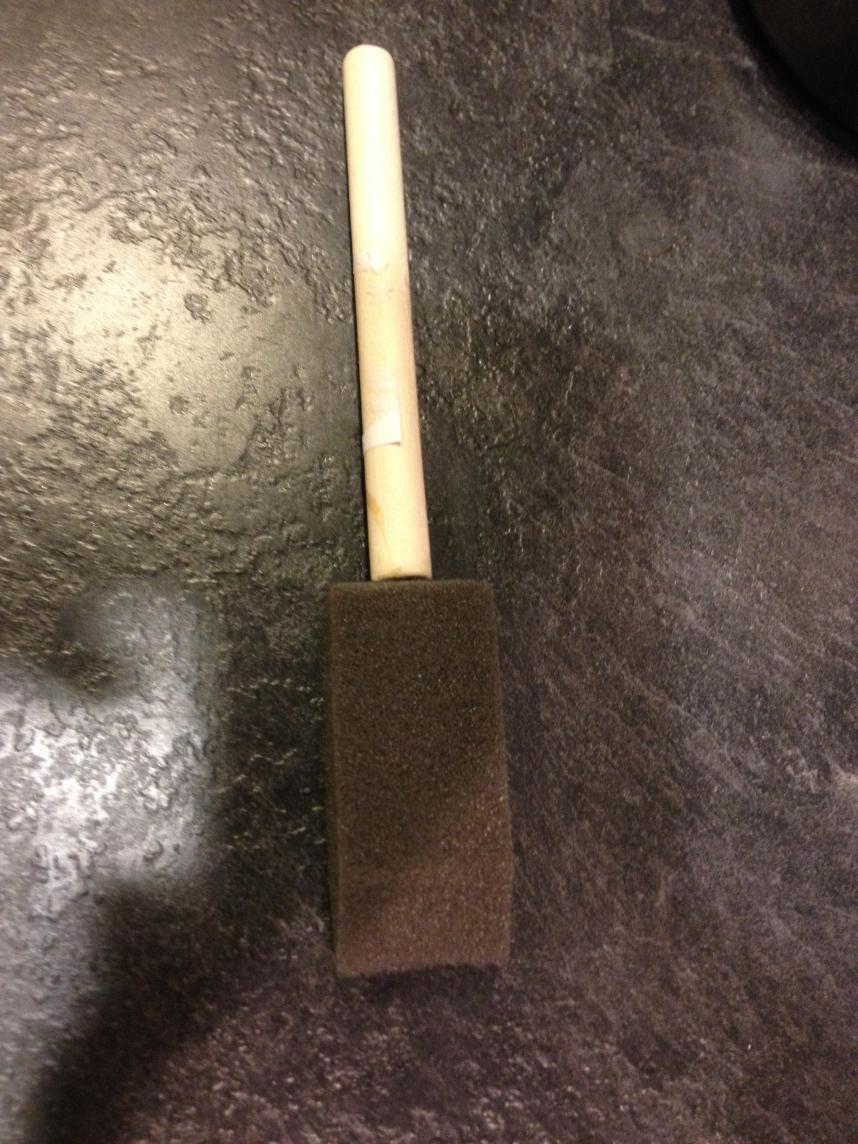

As i was wandering around a local hardware shop, i came across these paint sponge/brush's. If your looking for a bit more clearance for your TBS, then here is a bit of inspiration. Take off the sponge ends and attach dowel to quad using 2 zap straps/zip ties. works great and stops bottom of TBS getting wet from grass etc when you land or take off.
