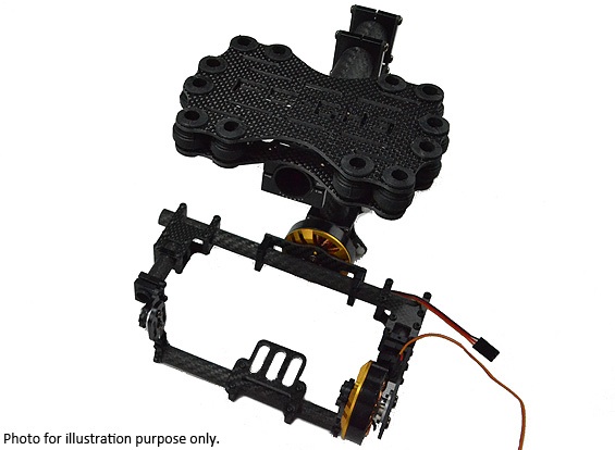

Ive just assembled a gimbel for NEX5r and som 4008 motors from hobbyking. I Got the controller from tarot coz i thourght it was easy to set up.. Now I cant get the damn thing to work.. Its shaking like hell, dosent really steady the cam, and i tried to adjust both gains and motors..
Thinking maybee it's not possible to use that controller since its made for Gopro cam ??
Hope someone has experince with this.. If not that controller, witch one to buy then ??

Tarot dosen’t make brushless controller as far as i know? Or are you talking about the board that comes with the 2-D gimbal. If so that is proprietary board for that gimbal specifically set up to work with the motors of the go pro gimbal.
wense
Ok, then I better understand why its not working :-/ And yes.. Its the controller used in the Tarot t2d...
