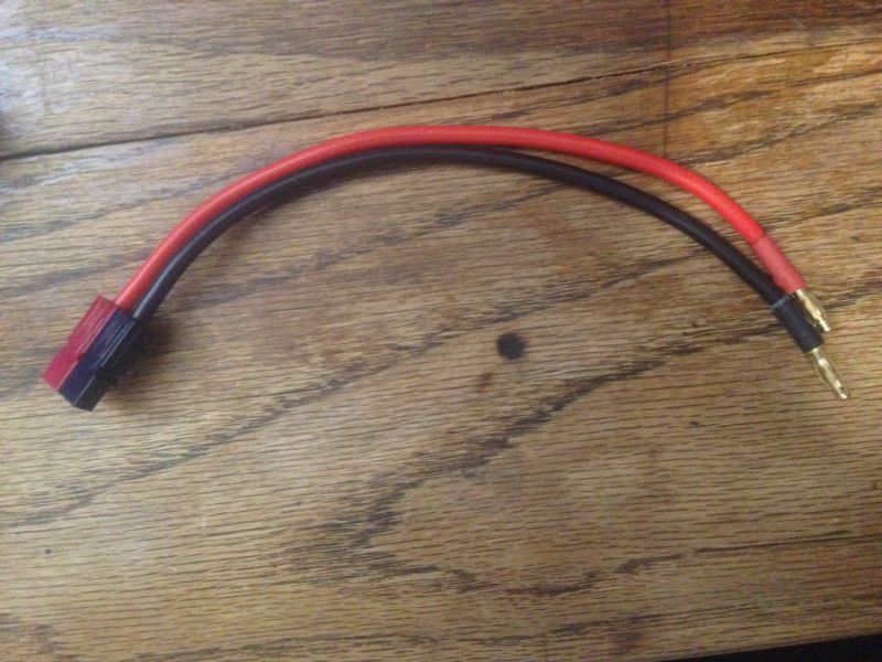

I started working on my power supply since going to a 6S battery mean I need a bigger charger and more amperages/watts to charge it.
I purchased a pair of Dell 700AB off Ebay total price was only 12.00 for the pair. And also purchased a couple of 4mm bullets which was like 6 dollar for a package.
Total cost for 24v+ power supply - less than 25 dollar which is not bad at all.
Also I made some charging cables using 12 ga silicon wires and Anderson Powerpole connectors. It at 9 inches long but I think I should had gone 12 inches.
Reason I went this length because of balancer port cable was 9 inches as well too so no point making it any longer when balancer port doesn't go any further out from the charger. But I still think next cable I make will be 12 inches .
I did lot of research before choosing these for my connectors and I believe that I will be quite happy with it.
What neat about it that there no male/female counterpart and you can snap it together making it into one connector or unsnap it again making it two different connector if you want to hook it up in series etc.
