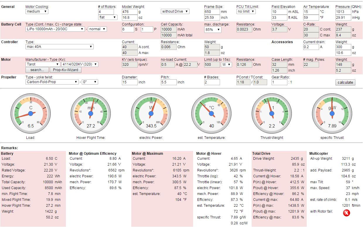

My planned buid is:
Tarot 650 IronMan frame
PixHawk flight controller (clone)
http://www.aliexpress.com/item/Pixp...ntroller-I2C-RGB-PPM-Neo-M8N/32316396160.html
4114 size 320 kV motors (didn't decided yet which manufacturer)
These could be good enaough?
http://www.aliexpress.com/item/Taro...48&btsid=4f0ea97e-824a-4fba-8347-676493e06d2a
Or this?
http://www.aliexpress.com/item/Free...48&btsid=963281f3-5268-4b9d-b13d-8486be48f0aa
15 inch CF props (if 16" could be used it would be great - really increased flight time)
10 000 mAh 6S LiPo
FeiYu Tech New Version 3-Axis Mini Brushless 3D Gimbal with camera and FPV
http://www.aliexpress.com/item/FeiY...-for-Gopro-Hero-3-Gopro-Hero/32407884605.html
FrSky Taranis transmitter with FrSky X8R receiver
Here is screenshot from ecalc:
  • 2016-02-08 17_37_54-Mans - eCalc - xcopterCalc - the most reliable RC Calculator on the Web.jpg
