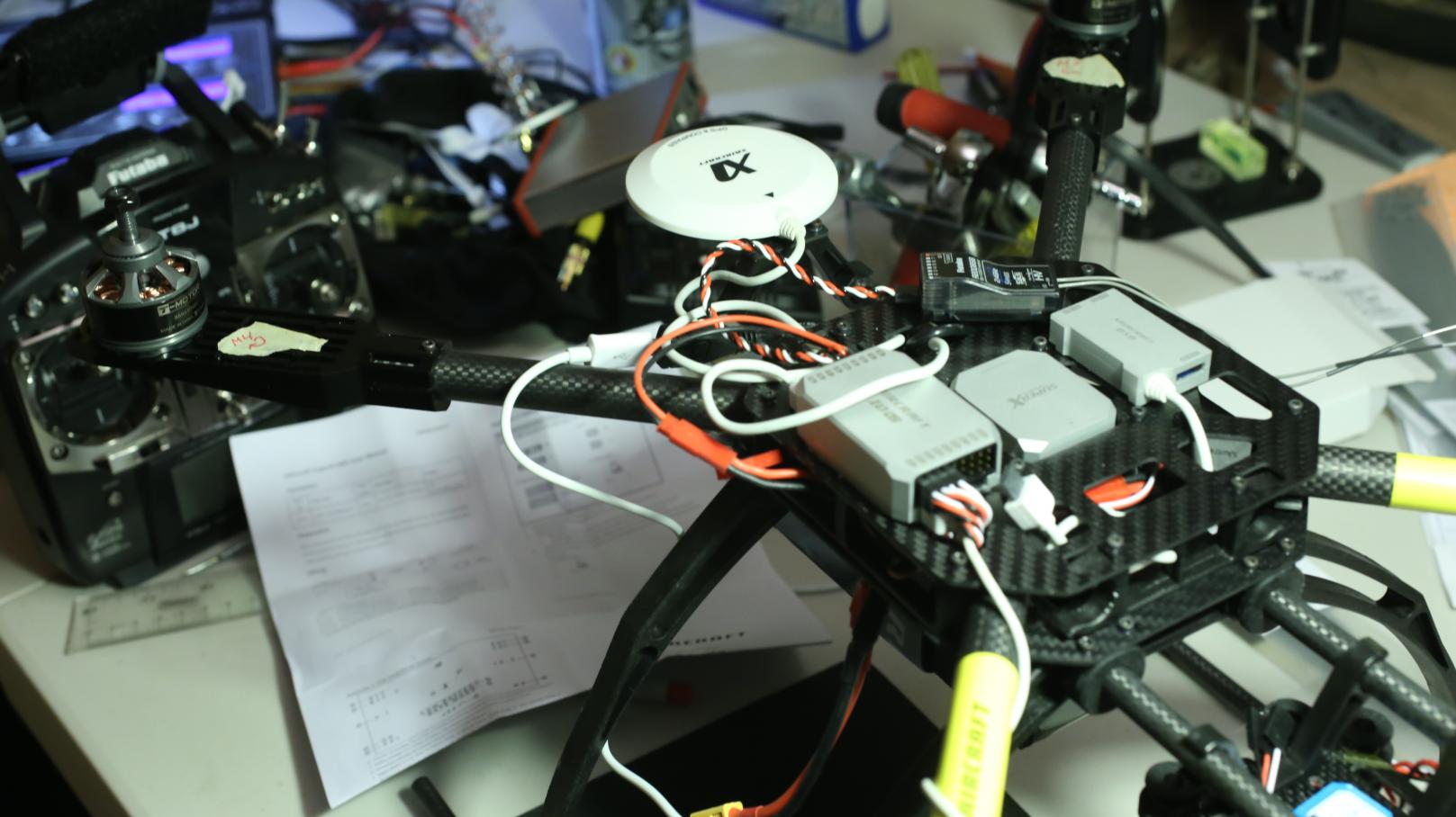

I just did a flight in 14 deg F. with my SuperX on my 530mm Quad. no issues at all.
5 mph winds...View attachment 15090
