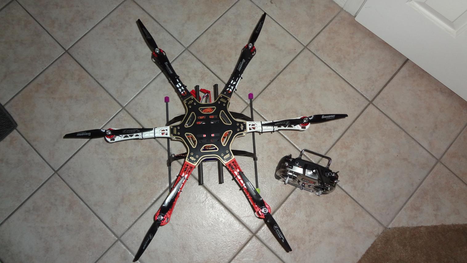

Hi Jack,
Thanks for sharing, I'm in process of changing over the motors 800kv ( 2216) start all over again with gains setting and props sizes i will report back to this thread with the result..meantime i have other build Hexa lately i haven't had a time to
fly around but i will soon…here is the picture of my Hexa View attachment 2715
Shiu
