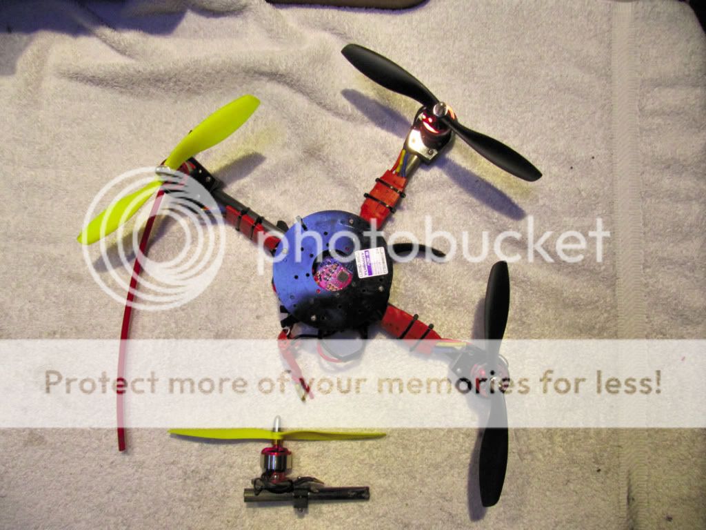

I really like the way it flys and it just wants to loop and flip. After the first flight I got more aggressive with it and started doing a few loops and tried a flip or two, probably the easiest I've ever had one of the little quads do it. Then I got a little too brave and tried to loop it at a much lower altitude and that was a big mistake as it was too low to pull out and recover, here's the result...

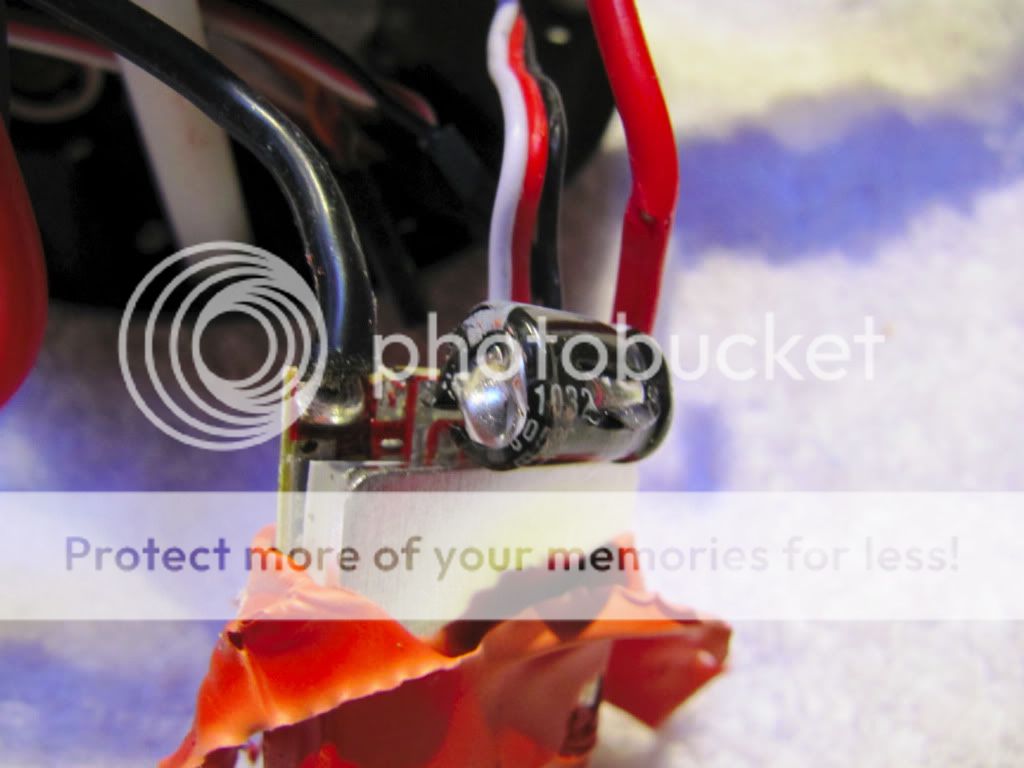

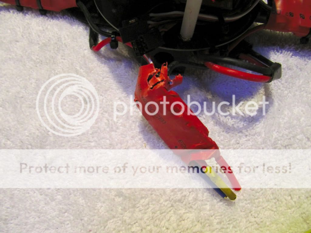

It hit right on the end of the arm and pushed the motor and mount about half way down towards the center plates, problem is the ESC occupies much of that space, or at least it did. When I got over to where it went down I saw smoke billowing out from underneath, thought I was about to see my first lipo fire up close then I noticed the pack off to the side still connected. When the motor slid up the arm it squashed the ESC between itself and the center plates the smoke was from a shorted capacitor...
As soon as I disconnected the battery the smoke stopped, not sure what might have happened if it had taken a little longer to get to it, maybe the smoke would have become flame or if the short was bad enough the pack might have eventually lit up.

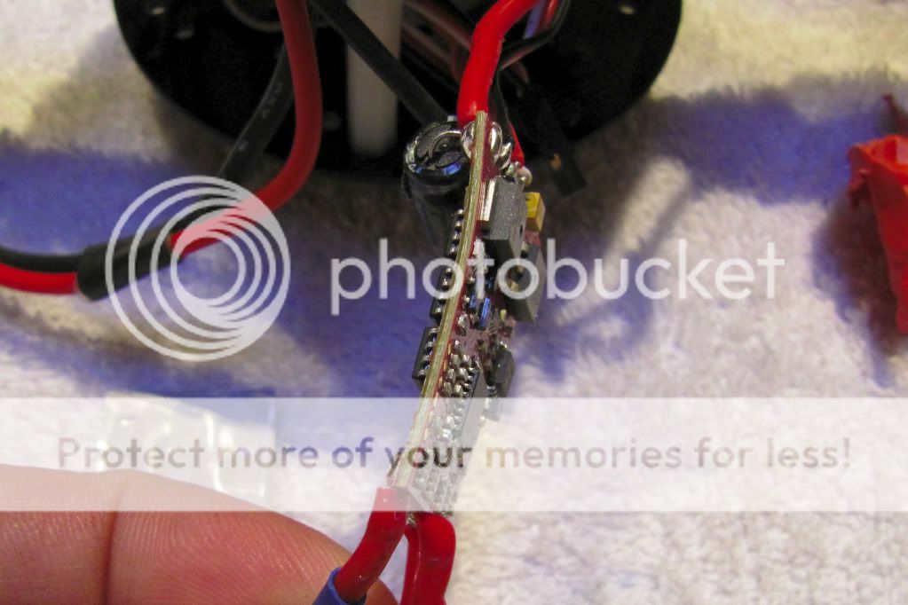

As it is the ESC is toast, take a look at the bend in the board, this one is going in the trash bin as soon as I strip off the connectors...
Oddly the motor and prop are fine, didn't even bend the shaft in the motor! The arm is trashed, ESC, the case of the receiver is broken, and a couple of the pins bent where something obviously smashed into the RX connections and pushed them back a bit. I haven't tried to power any of it up yet so too early to tell if that's all the damage or not but considering how hard this thing hit the ground it survived remarkably well.
