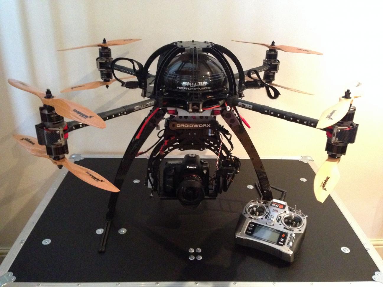

Do you have any pictures showing the GPS location? I have almost the same x8 , AV 200, Wookong . I am having a big problem to get stable video with the tarot stabilization on the av 200 !
iceman
Hi Richard, if your GPS antenna is under a prop I'd say it's too close to the motor (magnetic field) but without a picture of your set up its hard to say for sure. Just curious who John Cunningham is? I also use AV200 and would like better results from it.
Dependabletv
Always learning
View attachment 14687The GPS RX is on the left hand rear boom as you look at this photo. It's just under the tip of the props but the cables run next to the power feeds for the motors. My first plan is to move it to on top of the crash cage to see what that does. John Cunningham is the chap that invented the Radian which he then licensed to Freefly. They don't like talking about Joh but boy does he know his stuff compared to the FF Radian forums.

I've spent quite some time setting up my gimbal but using RSGS has been a challenge, it stabilises really well holding the horizon every time and tilt but I still have some occasional jitters I would like to eliminate if possible. Looking at you rig I would move the GPS as you have planned and make sure it is orientated in relation to forward direction. RTF are always going to be a challenge to set up compared to self build as you won't have the benefit of knowing how each component in the build has been installed and setup. Hope you get it sorted.
So you know I just built my first DW Skyjib 6 ti and I put the GPS/Compass on top of the crash cage.
Everything is flying really well at the moment with the latest Wookong firmware.
I took the aluminium GPS holder that came with the wookong, and tapped the hole in it so you can screw it though the hole at the top using a bolt.
That way there is no need to have it stuck to the top, and you can turn it to whatever angle you like at any time.

Cool, well in that case I would try mounting the GPS on top of the crash cage as suggested by some others here - we havent had problems mounting it on the boom on flat octos, but maybe with the shorter booms on the X8 its too close to the motors. We have it mounted on top on our X8, and also some copper tape on the underside, which may help. Good luck!
