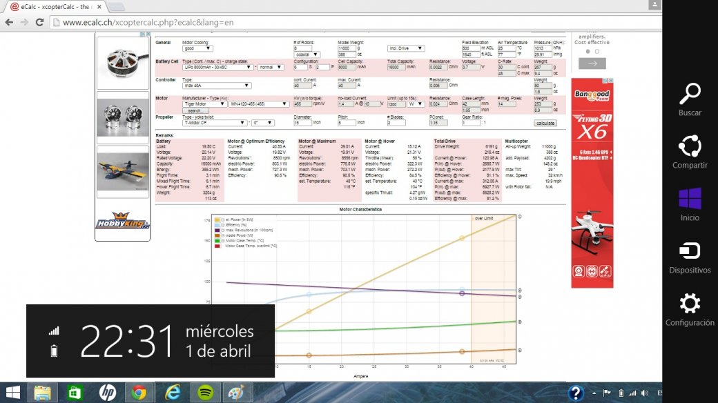

I,m dueling between the 4014 400kv and the 4120 465kv, the only problem would be that 4120 would probably demand a 60-70A esc and I can t aford changing both..Do you think that 10.5kg is doable with 40A ESC!?
If not flogget and will roll with the 400kv!
henrysj
Get cracking on eCalc. 40a speed controllers will be fine though. I'm over 11kg on my skyjib and using the herk board which is 30a
What are you flying at the moment Henrysj?
Heres an ecalc with the 4120!Just on the limit, but not very impressed with flight times..

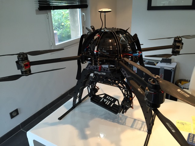

Hi there,
Chopper is in the air again!
Changed motors to 4014 400kv and got 12.5 min with AUW 9.2kg with 16A.
Also set the custom mixer recomended for the wookong and it feels beter.
