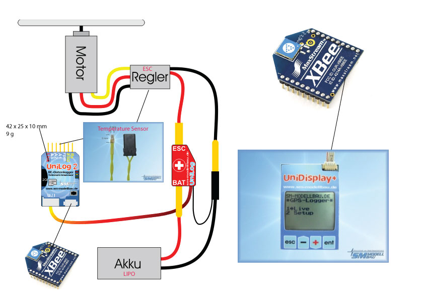

Nah i am going to find a way i want a small display at my remote like the JETI MK setup just giving me the basic info.
May the UNIlog2 in combination with Unidisplay and Xbee can be a solution lets see.

I was thinking about the eagle tree solution but it is quite heavy and pricey.
Might got the uni components way. Give me temp ESC bat voltage A being used and everything either life display and/or sd card log.
Little shaky if it will work with xbee lets see.
