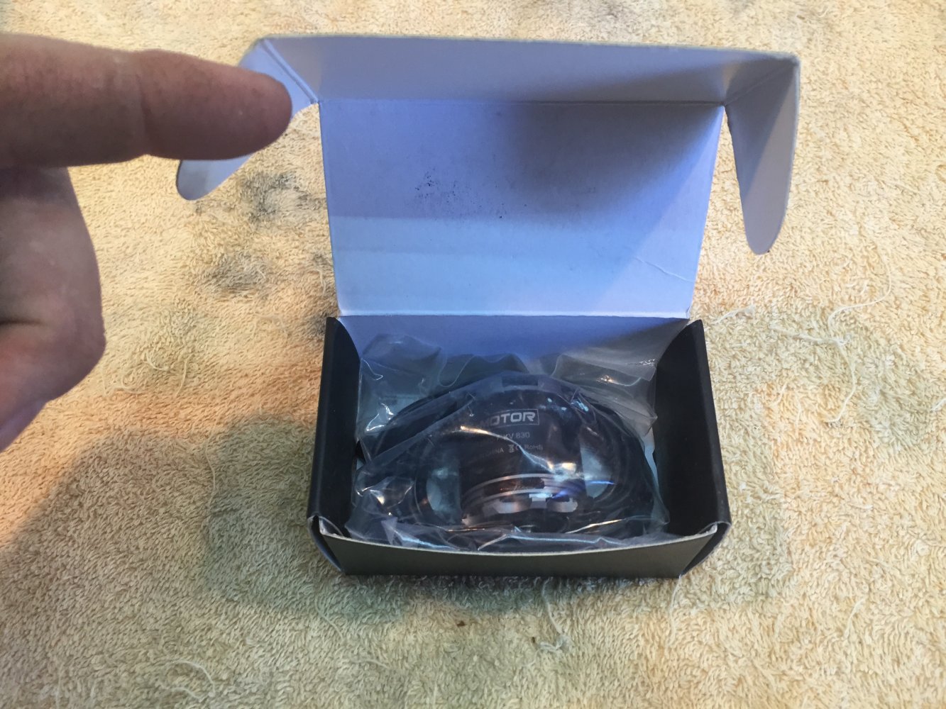

For the past while I've slowly been building up a strider 280 to be given away as one of the awards for our outreach flight school program. Would love to be able to get something pre-configured but we gotta do with what's donated and in our budget, on to the meat.
Frame assembly was simple as most frames this size are. I'm using the following components
SkyStrider 280
Scorpion M-2204-2300kv motors
RMRC 12amp BL12 ESC's
Naze32 Full w/ cleanflight
EZUHF rx (testing with D4r)
Immersion 5.8 600mw VTX
Mini minimosd
I have the power train done and was going to start tuning the FC before I put on the upper half with the FPV gear on it. But in angle and horizon modes it dances around quite a bit even with the Baro and mag on.
Anyone know where I should start with PID tuning or is there some sort of auto tune?
