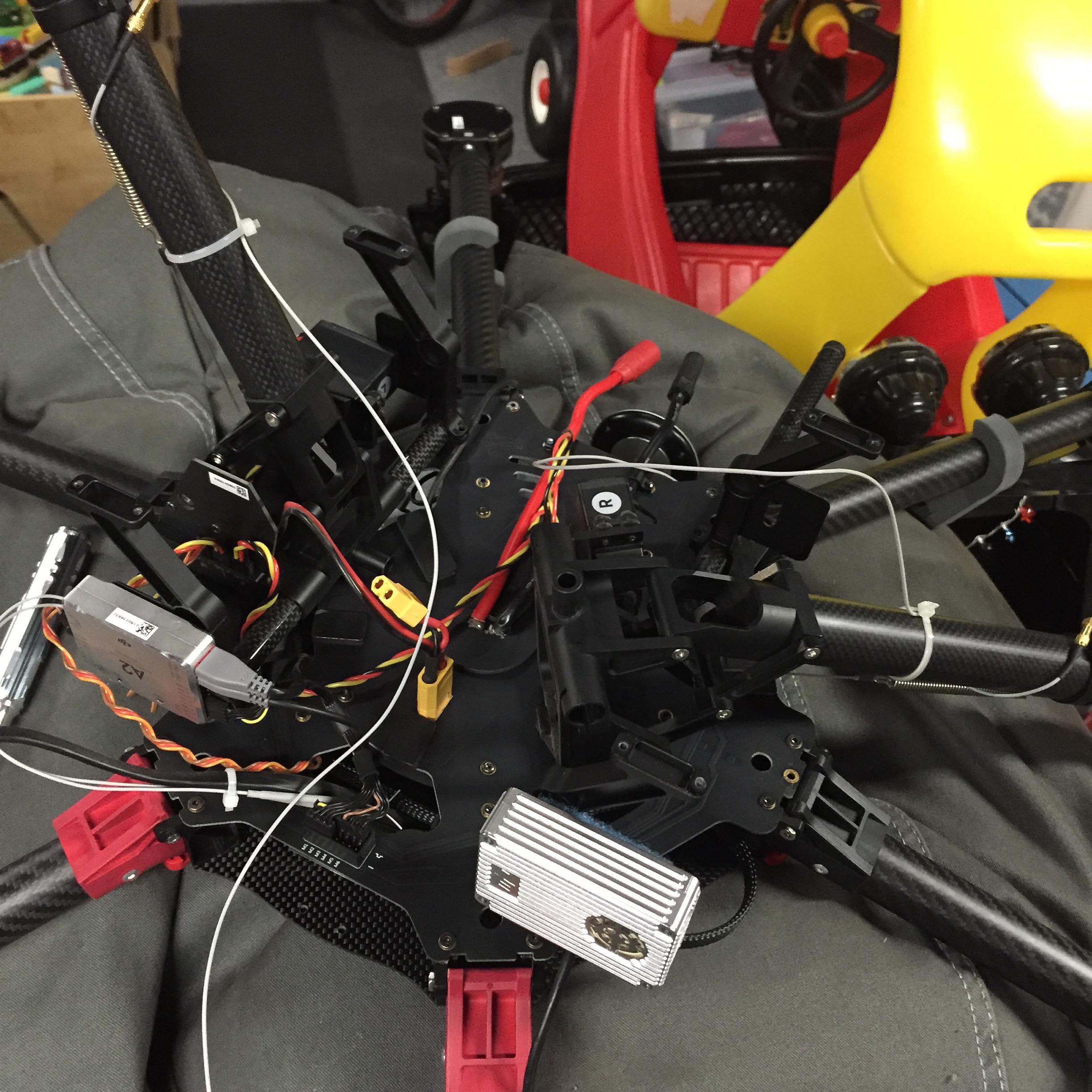

A typical photo of my S900 inspection rig...this thing is on the bench more than in the air...when if flies it's awesome but boy way way way too much work...plus about to downgrade to the inspire with x5 or the yuneec - can't decide which...like the idea of the S900 but sick of messing with it. - photo below is my last attempt to get rid of some very poor harmonics that are getting transferred through the landing gear to the gimbal when the gear is up...(this one has suffered from pretty poor dynamic vibrations for the last few months...trying out some prototype props from xoar and hoping that might help in addition to all the standard tweaks and tricks...hoping to get it perfect and sell it...LOL)

A typical photo of my S900 inspection rig...this thing is on the bench more than in the air...when if flies it's awesome but boy way way way too much work...plus about to downgrade to the inspire with x5 or the yuneec - can't decide which...like the idea of the S900 but sick of messing with it. - photo below is my last attempt to get rid of some very poor harmonics that are getting transferred through the landing gear to the gimbal when the gear is up...(this one has suffered from pretty poor dynamic vibrations for the last few months...trying out some prototype props from xoar and hoping that might help in addition to all the standard tweaks and tricks...hoping to get it perfect and sell it...LOL)View attachment 18
Maxx4wd, that's a nice collection. Your post about the harmonic vibrations in your S-900 is not terribly negative, they did have these issues. I got mine sorted out and now it's a great machine (it took a while though). Here's what I did to stiffen up the frame: 1-epoxied the carbon fiber cross bar between gear legs onto the knobs it sits between (I assume that's what you were doing in the pic. 2-I upgraded the motor plate dampeners to the softer ones (they are a DJI upgrade/replacement part). 3-I replaced the top plate with a thicker, beefier one from Kopterworx. This fixed my S-900, there are no vibrations at all now.
maxx4wd
Petr,
Yes this picture was the epoxied cross bar fix...and like you I also did the kopterworx top plate...in addition to the more rigid top plate it looks way cooler too...:) I have done the pillow ball dance on the gimbal plate but have yet to do the replacements of the motor plates...I'll have to look that up. I ordered litterally every single damper that DJI made and a few aftermarket options as well...so I bet that I even have them already...right now I only get a little high frequency jitter when the gear are raised so I'm hoping the cross member epoxy fix will help this...also interested to see how these xoar props help (if any) but it is a process for sure - just very annoying when your battling harmonics on a "pro" grade copter...as an engineer nothing makes me more frustrated then poor design...especially since this could be fixed by going away from temperature influenced rubber dampers and using steel hoops like all other pro grade copters....
