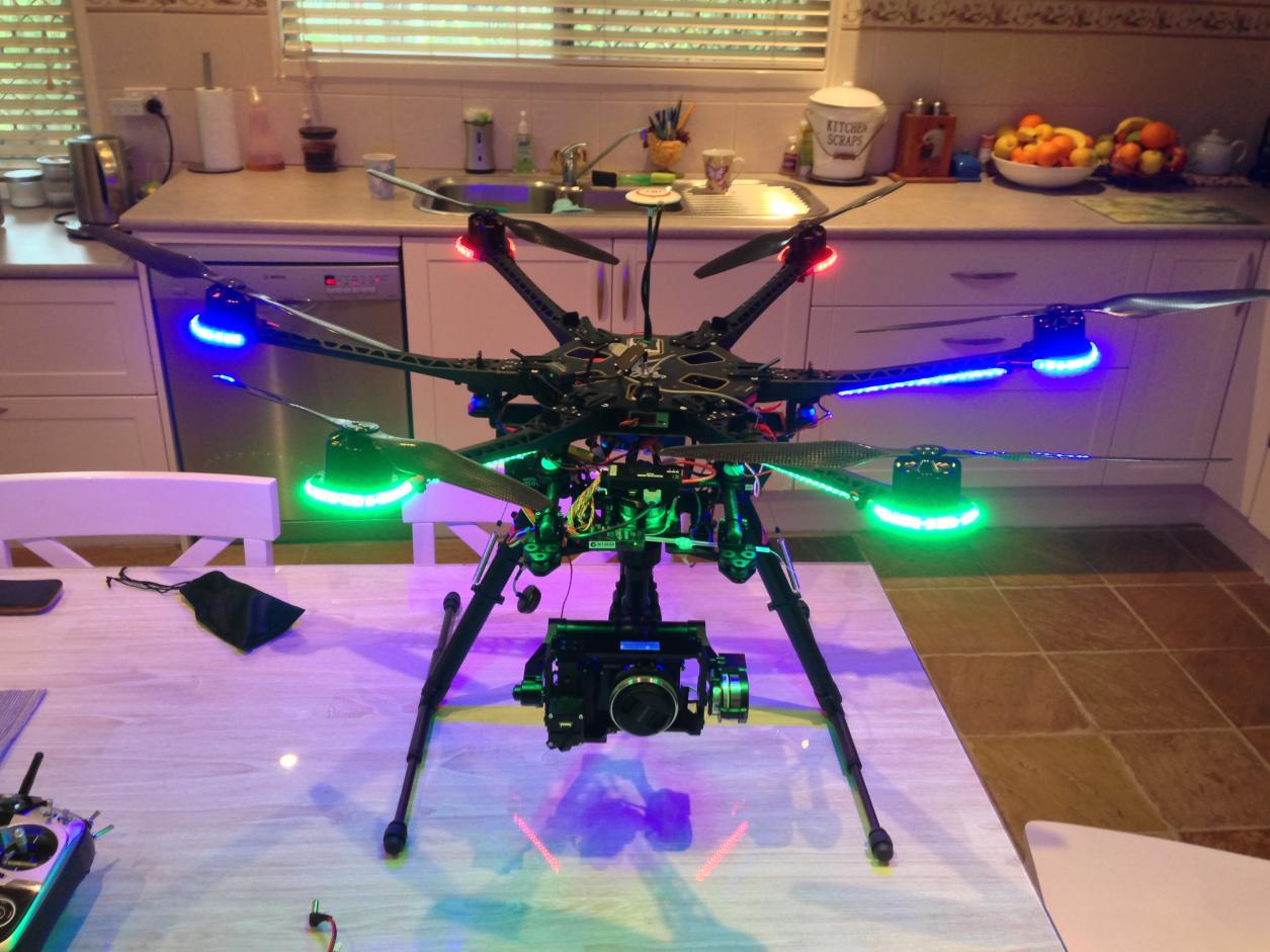

Nearly there I think. For those interested, here is a shot of my fully built S800:
Once again I'll post the results for others who may suffer from this issue.
