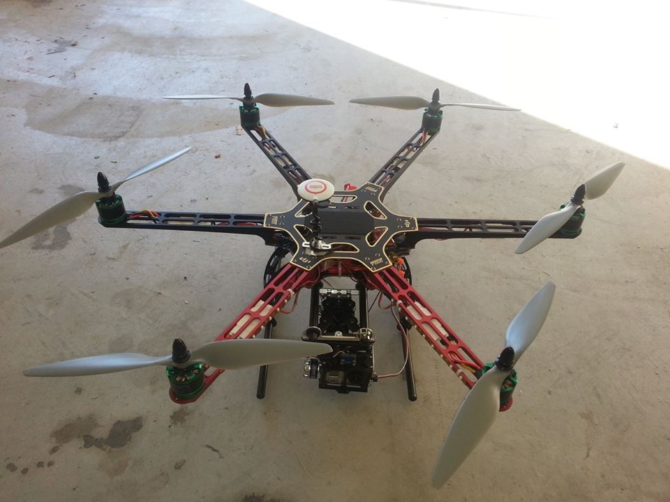

S800 evo + zenmuse z15 vibrating / shaking like crazy
I am trying to figure out what I am doing wrong, (see video) I have no idea why the Zenmuse and everything is shaking so badly (you can visually see the zenmuse and batteries wobbling like wild). The footage is unusable until I figure this out. Any tips would be greatly appreciated! My setup: S800 EVO, Wookong M, Zenmuse Z15N, (2) 6000mah batteries, 5.8 GHZ FPV downlink, 5.8 GHZ rx for flight controls, 2.4 GHZ rx for Zenmuse, IMU mounted on IMU bracket (but has also been mounted on hex core itself, no difference in vibration).http://www.youtube.com/watch?v=BlD2Fpr9oTU&feature=c4-overview&list=UUHzMg_w6HcAPlrpMv2gLLBA

Thanks, boranup. I think my problem is slightly more embarrassing. I don't understand gains and I had them all way too high (170-200). I started reducing them and immediately see the vibration getting less and less and less. Does that seem about right? I am just such a beginner to this stuff. What gains do you use AND did you mount the IMU on the IMU bracket like I did (because they said to further reduce the gains if so).

My gains with two 5050 lipos and GH2 Zenmuse are around the 170 and 130 mark - this gives me quite smooth flying and makes the craft far less twitchy. I agree the gains may be a cause to your vibrations and you need to dial these in but the 'shudder' I see in your Zenmuse is the same that I had and it was caused by misaligned props as my gains havent changed. My IMU is mounted on the landing gear on the supplied tray
