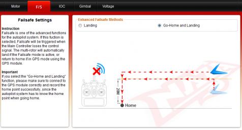

The settings in the naza software are set to Go-Home & Landing:

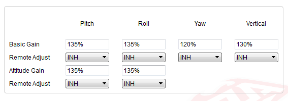

On startup I let it sit for about 60 seconds until the LED flashes green a bunch of times, so I think it has GPS signal. I also flew it more than 10M away from home position per the instructions before triggering failsafe. I haven't adjusted any gains or anything yet (though I'm not sure that would have any effect on autopilot?)
