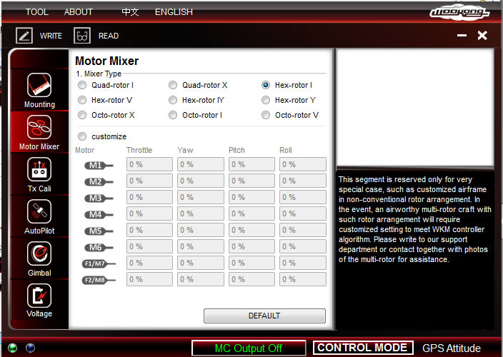

Ya - I had some issues I was seeing with my x650v8 but after getting to a point where I did not trust the craft I decided to take a bigger plunge, I went out and purchased a wookong-m. At that time I had to up grade the esc, however even after that, although it flew fine with no payload once I started getting it up to 2200g I did not like what I was seeing. I had a few crashes probably my fault more then the crafts, however some craft faults, and so on. At that time I decided for my purposes I want to make sure i was at the best position I could be at. I then purchased 4 new motors (avroto 2814 - fit right on the current xaircraft motor mounts), I had to add a one very small washer to add space over factory set screws - for better alignment) and ESC's that could handle the new motors demands (Maytech Harrier 30amp).
So far I am still in the testing stages however what I am seeing has me much happier with my decisions, there is a difference.

ya, I went from 8 to 4, I mainly made that decision from conversations I have had from people around the net. As a few said, it usually is not the motors or esc's that fail, its usually a bad soldering or something else.
I also read somewhere that some guy had used something like 40 of these motors and all had over 100 hours with no problems in any of them. I have to say the motors are something to see they are well build and they have the ability to throw out 4800g between the 4 of them. I am at 2200g and I like knowing that I am around 50% of its weight. I thought about going up to eight motors, however that many may not let the craft come down.
The change over was pretty straight forward, if you spend the time with it, you can get the motor wire to align strait up the arm oppose of going to the end of the boom and curving over and under the motor mount.
The only gotta which is really not a problem was trying to figure out where the ESC's could fit. They are to big to go in the arm so I put them into the side of the frame, two in the bottom layer (one left side, the other right). Then I put a set on the upper layer in the same fashion.

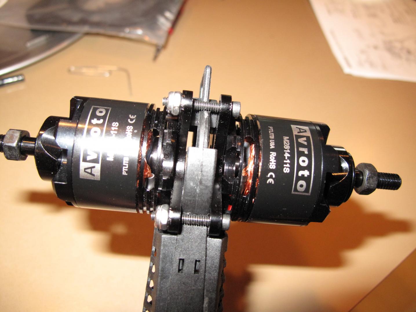

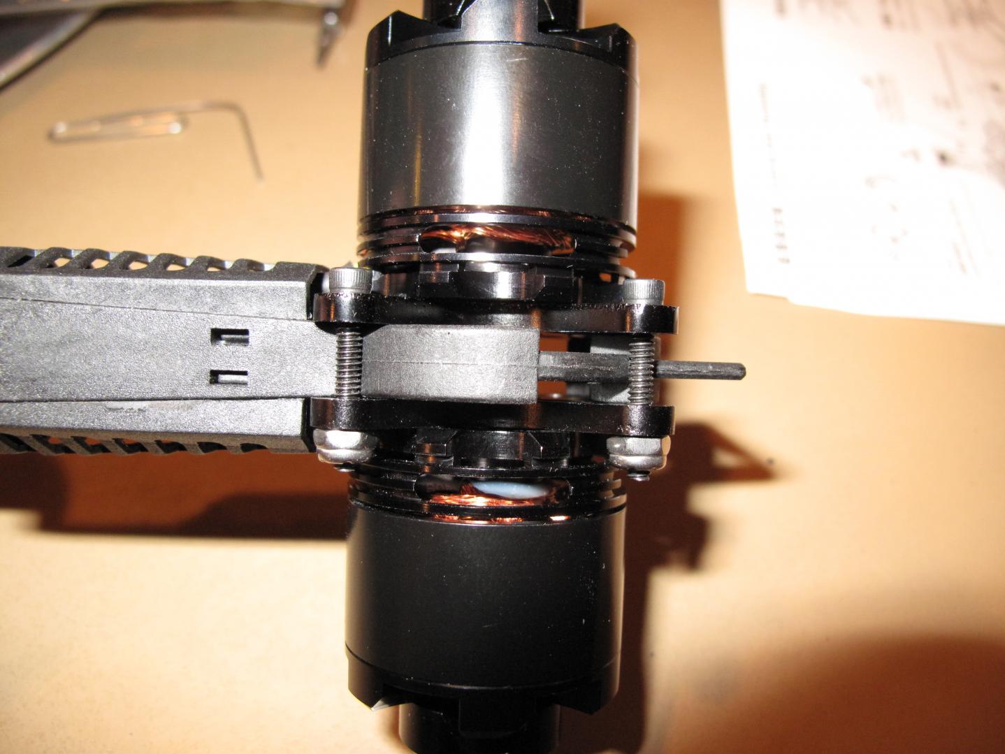

Dixter
View attachment 1490View attachment 1491View attachment 1489
Lets see if this is any better...
OK.. these three pictures show the motors mounted on the Xaircraft motor mounts at the end of the boom.
The X motor mount comes with the motors in the box... all that is needed are the four long screws and the
nylon nuts... The X mount fits very very snug, there is no slop or play. Also notice that in this configuration
the wires now do not have to go to the outside of the boom and brought back in... you just slip them into the
boom under the shrouds...
