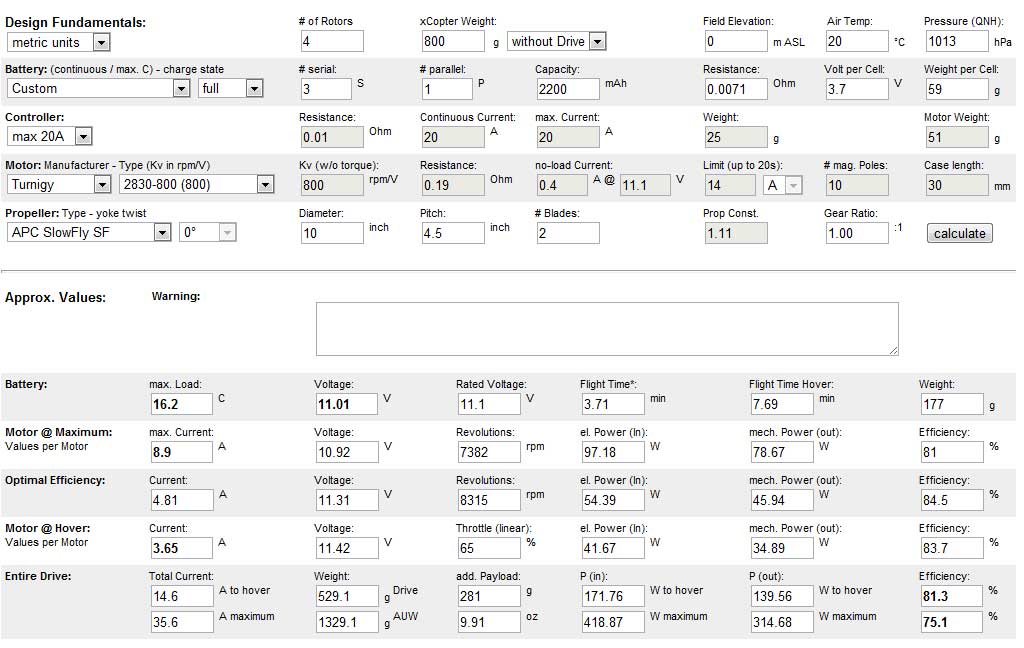

It just doesn't work for mine. It's about 1300gr AUW, quad, 2830-880 motors with 10x4.5 props, 3S-2200 battery. If I do it as "without drive" and a weight of 800g, is says 80% throttle to hover, 5.5 minute flight time. Not true at all. It hovers about 40-50%, and at least 7 minutes.
It gets a little better if I put in my FPV setup, about 1000g on the frame and camera, 4S 5000 battery. It says 65% hover (a little high), and 11 minutes hover (I'm not positive yet, but that's about right).

jes1111
Damn silly image attachment system! Bart!?
As close as I could get with the numbers you gave.
Ok, that looks pretty good, other than I think the throttle % at hover is high. It's more like 40%. But then maybe that is being masked in the code because there is some rescaling going on. It's no Ferrari in any case. The flight time is almost spot on.
