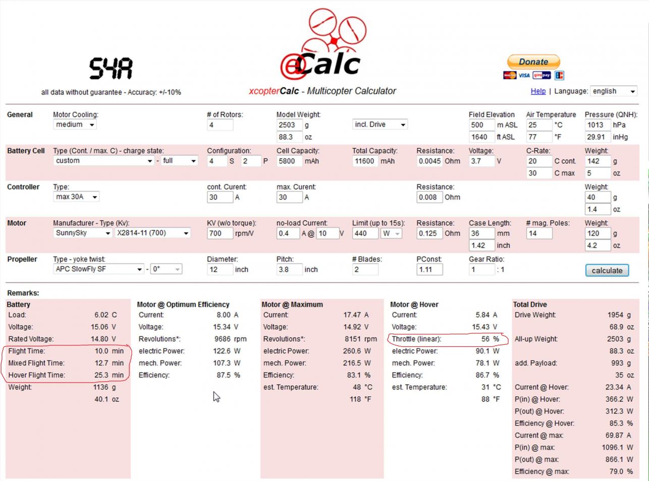

1st combination: prop 11x4.7 , 2xbattery 5A, 30A simonK ESC, SunnySky 2814-11 700KV motor
AUW in 1st combo: 759G(frame,electronics,fpv system,cables and other small stuff)+4x32g(4 ESCs)+4x120g(4 motors)+2x488(2 batteries) = 2343g
I don't like it very much because of the 59% of trottle i have to give so the quad can hover.
2nd combination: prop 12x4.5 , 2xbattery 5.8A, 30A simonK ESC, SunnySky 2814-11 700KV motor
AUW in 2nd combo: 759G(frame,electronics,fpv system,cables and other small stuff)+4x32g(4 ESCs)+4x120g(4 motors)+2x568(2 batteries) = 2503g
I don't like it very much because of the shorter flight time.
3rd combination: prop 12x3.8 , 2xbattery 5.8A, 30A simonK ESC, SunnySky 2814-11 700KV motor
AUW in 3rd combo: 759G(frame,electronics,fpv system,cables and other small stuff)+4x32g(4 ESCs)+4x120g(4 motors)+2x568(2 batteries) = 2503g
My favorite combination of all 3,because of the ballance between as less as possible trottle needed to hover and as much as possible flight time.
So what do you guys think can i change something to make it better, am i missing and/or mistaking something.Feel free to criticise me. :)
Cheers,
Stanislav
P.S.Excuse my poor english.:)

That looks pretty good. I would maybe try to find a motor that can get you down to about 50% throttle, but this one you list will probably do just fine. Realize that it's not exact - and you may be able to save some weight here and there to bring the load down, making it easier to get the craft off the ground.

I will probably go with this setup, if it hovers at too high trottle i will change the propellers to 12x4.5 i will loose 1 minute of flying time but the trottle will be at about 51% or 5% less. About the FPV what do you think about this setup:
