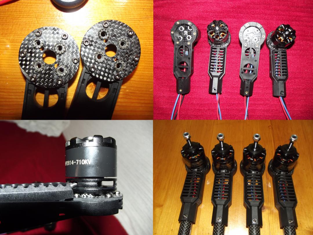

My solution was to drill an extra two 25mm holes into the carbon plates and mount the motors on locking washers:
After assembling all of the motor arms I assembled the frame, being careful to make sure everything is in place and thread-locked

The first problem that I encountered was that the motors I had ordered did not fit my motor mounts. (motors had holes of 25 and 19mm, the mount had 16 and 19mm).
Results:
The final result felt sturdy...
