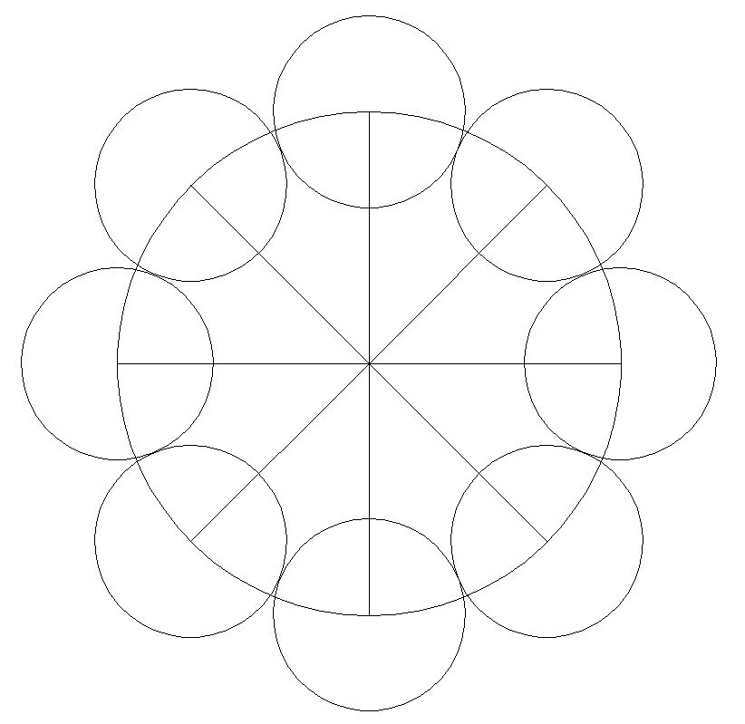

See attached for an Octocopter I designed......... I had someone in our AutoCAD drafting dept..... throw this together so that I would not have to do the calculations manually.... If the tips do not touch even when there is vibration etc. you are clear for takeoff!!! View attachment 13955

i generally try to keep tips 1/2" from each other. seems to work fine and that's how my first MK kit was set up (Nov 2010!) although that was probably 13mm :)
