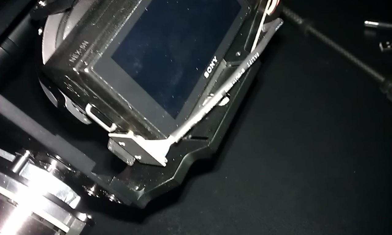

Sorry but this is a HDMI and not a mini HDMI adapter !
Zenmus has a mini HDMI connector !
Zzr
