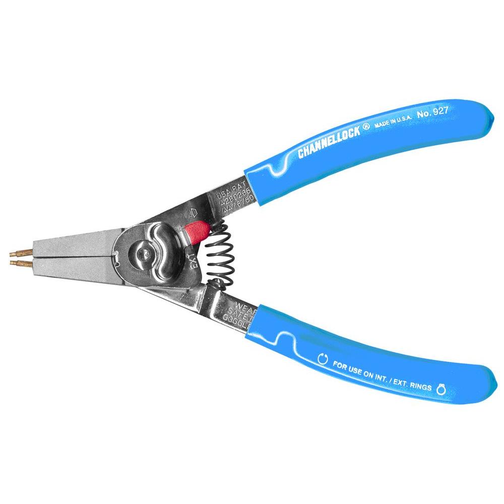

Are these what your talking about? http://www.mcmaster.com/#retaining-rings/=qndjt0
Yes....... choose the external type with the little holes so that you and use an appropriate insertion/removal tool...... the most effective way.
And don't be scared of spending extra money on a top quality tool for insertion/removal. Otherwise you risk a failed retainer ring and loss of prop c/w rotor in midflight.
