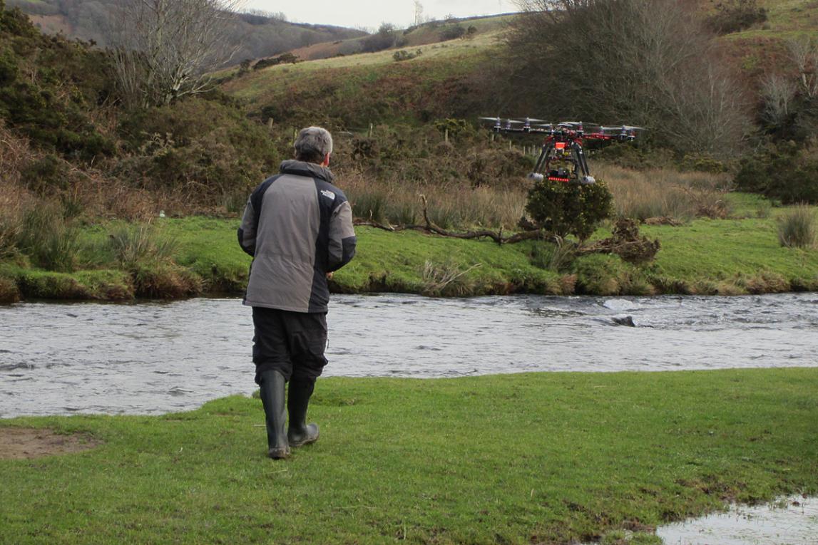

@Ross brave flight over water for your second run!
Macsgrafs
Eh Up Lance keep us posted on how you go on..
Dave, Im not the full ticket ;) ;)

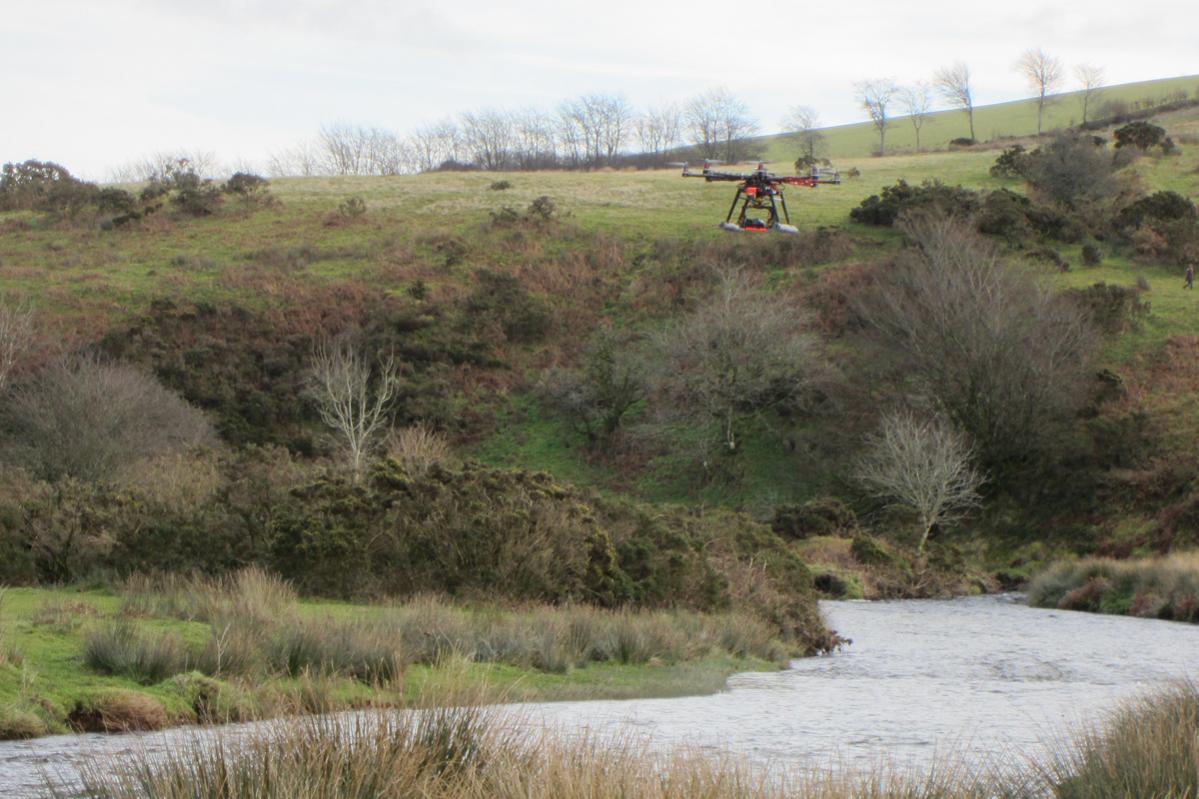

My first ever flight with an RC 6ch heli & camera was over the sea...I am surrounded by the water down here, so I jump in at the deep end (excuse pun). I did fly the octo over a Exmoor stream in these shots...the water is only 3ft deep at the max, wade-able so to speak ;)
