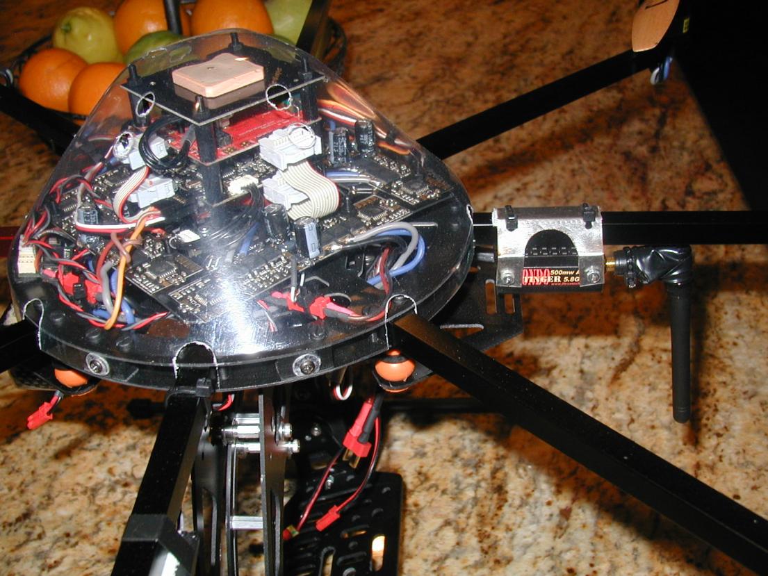

While we're talking about Tx antenna placement I thought I'd ask for the site's review of my own installation. I'm not having a great wireless video experience. By my second flight I'm losing reception and figure maybe the Tx is overheating? Maybe there's interference coming from the electronics?
Any suggestions would be appreciated. The Tx is a mondo stinger 5.8 ghz (500 mw) I picked up second hand last year and it's powered by a dedicated 3S lipo. It's amazing to me how little power the Tx and Rx use. The Rx is an Iftron Yellow Jacket that I bought in desperation when I couldn't get my ImmRC to work (partly my fault).
Bart
One of these days I'm going to collect all of those stock dipole antennas I own and burn them.
Does that answer the question? :)
yup, i replaced one of the receiver dipoles with a patch and it's much better. your next comment will be to get the four banger (looks like the three will work also) that Alex sells? How do you mount that on a multi? I'm not looking for range, just a high quality solid connection.

I would think the cooling fan is a good idea. I'm happy with the quality of my Iftron gear but I'm still having issues. It may be that my Tx is overheating or it may be that my goggles are not up for the amount of useage they're getting. I'm going to put my Stinger Pro on my Okto and see if my problems are from the Mondo Stinger. If so I'll send it back to Iftron for a check-up and maybe see about how I could add a cooling fan to it.
I added a single patch antenna to the Yellow Jacket and it works much better now. The two bi-poles look nice but they don't work very well.

Is that some aluminum holding your transmitter on wonder if that would have any impact on the signal strength?
