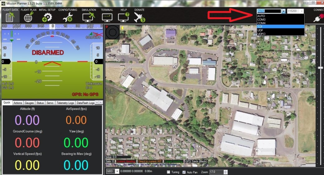

Chalagi
I looked for the auto accept the other day when I was in MP but I did not see it. I think I my have over looked it.
Old Man

'Auto Accept' can be found underneath the 'Live Calibration' compass screen. It's next to 'Rotate with each data point'.
But it is NOT in every version of Mission Planner. 1.3.25 has 'Auto Accept'. 1.3.9 does not.
