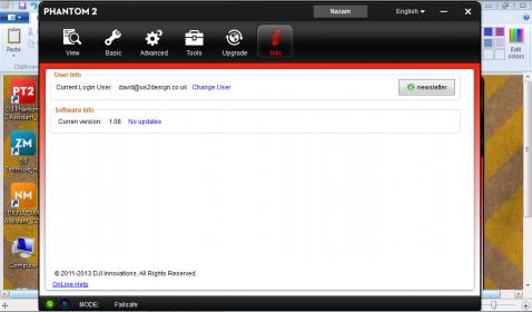

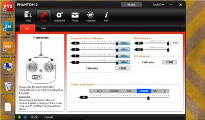

Here are screen grabs of the latest version of the Phantom 2 Assistant.
The option to change receiver type DOES NOT exist.
