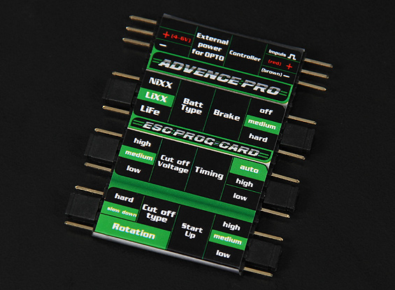

Also because these are VTOL aircraft I try to eliminate or at least minimize the battery protection when programming ESCs.... I do this by selecting the NiXX setting versus the LiXX setting. View attachment 19150
