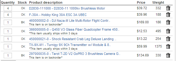

Wowzer, so much replies since i went to bed :D Taking all the advice on board, Looking at different frames because your right that one is quite heavy, looking at the Q450 from HK, they have a integrated PCB version and a normal, is the integrated any use? or just more to break. Will come back with a revised shopping list :) Although there is a dealer in AUS that sells the actual Flamewheel with the DJI motors esc and props,just add your own extras, but its 400$ :/ sheesh
This is my current list, i think i want to go with the Naza M lite w/ GPS, have heard good things and it should do what i want. I obv need prop, batteries, charger and balancer.

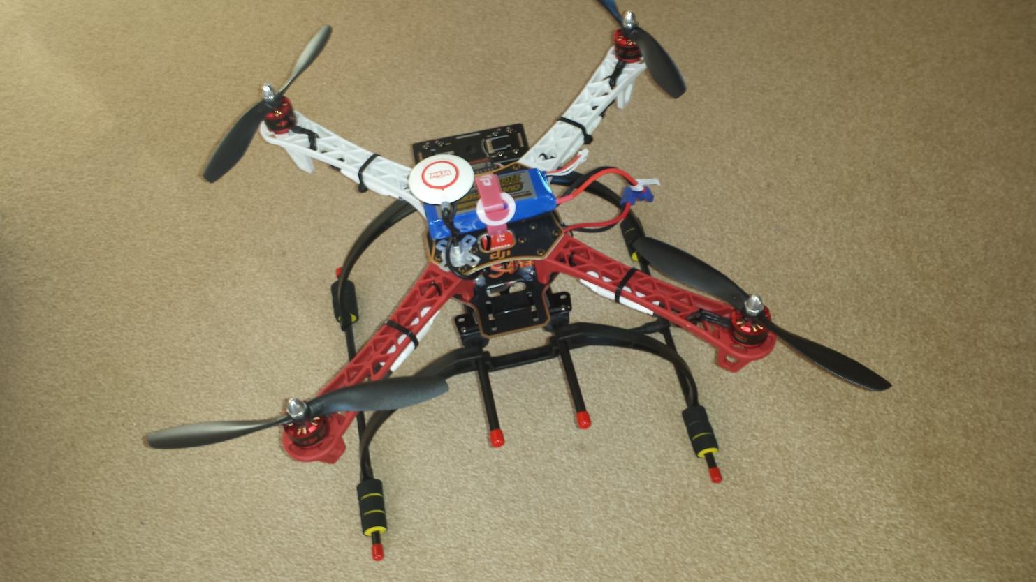

hey Savolion
i am just ahead of you i guess and starting to get some good results with a go pro hero 3, all about stability for me, i come from an RC background, but a semi pro photographer as well..i intend something bigger when i can trust myself to launch my EOS 5diii but for now my very capable training rig is as follows....cant recommend the Naza lite GPS enough, easy to use and steady as a rock...
These are the bulk of parts that i opted for, have left off the KK2.0 board that i initially used although it was actually pretty easy to configure and flew successfully , substituting the DJI Naza lite at £107 was a big step forward and really easy to use.
i also used www.quadcopters.co.uk and their site is pretty good as well.
for the 5.8ghz system i used a diversity screen and twin receiver combined from quadcopters and purchased the antenna and 600mW TX to suit from Hobby king as it was way cheaper and in stock..
legally the 600mW is way too powerful in UK but everyone is doing it….there are cheaper ones at lower power but the boscam one can work on all 32 of the 5.8ghz channels across four bands and my receiver can receive all as well.
The aerials allegedly improve the range and quality.

Thanks for the input, i feel like im getting pretty close, however im not sure on props to suit my motors, e calc says that with a 5000mah 4s 25c battery has enough power to supply my motors, and 8x4.5 props will get me in the air with 8 min flight, maths says my quad should weight between 1500 and 1800 grams with everything on board including gimble and go pro, however i did add a bit of weight just in case. Is that a normal weight for quads? or a bit heavy?
Motopreserve
See what 9" props can do for you. Weights can be all over the place. You just have to work with what you're lifting.

Seems like it , remember you would need 4 mm heat shrink for the bullet connector cause 3mm will be to small .
If you are a diy type of guy you could also get the f-30 esc's and the flash tool and flash them yourself , it will cost roughly the same as the afro esc's cost now but later when you get " addicted " to your build and you will :p and want to build your second rig it will cost you less money cause then you buy only the esc's for $10 a piece and flash them with the latest simonk firmware .
Don't know what the carefree breakfree in your cart is but if it's not blue threadlocker get it .
