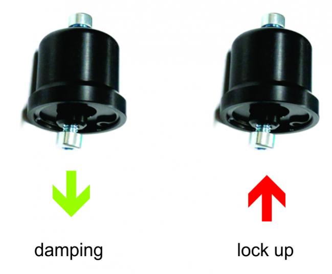

New inovative product on market, special antivibration adapter with lockup system.
Extremly light in alu case with hexa screw 3mm mounting on top and bottom.
For payloads arround 1-2kg u need 4 pieces, for 3kg 6 pieces, for 5 kg 8 pieces.
This adapter completely eliminate all high frequencies from motors and props.
And when u land there is lockup system.
Dimensions:
- FI 25mm x 25mm high
- weight 18g
Easy to install, video with Cinestar comming soon.

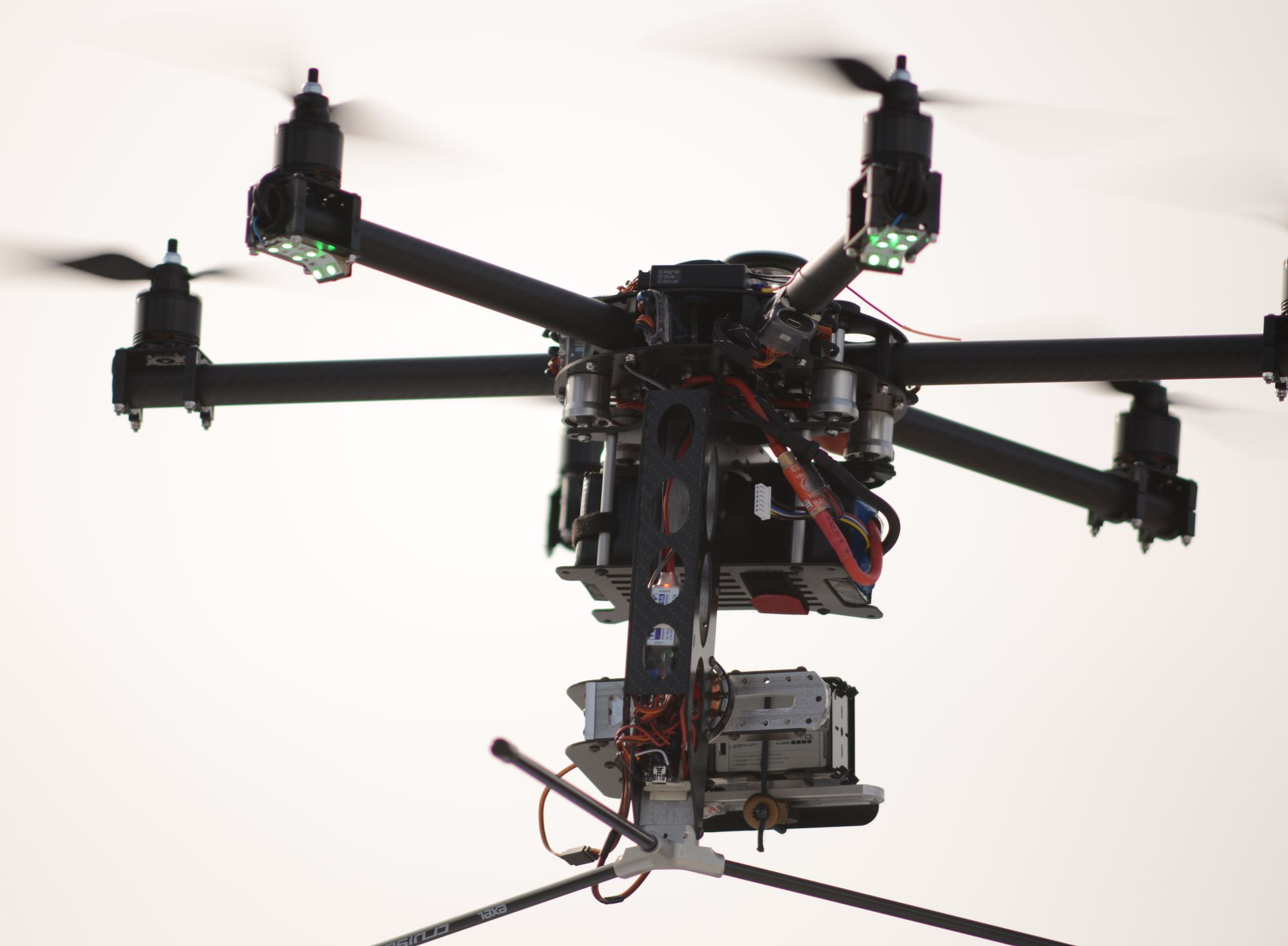

Dimensions:
- weight 18g
I cannot understand how it works..

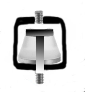

basically it is a silicone damper with its own case and it works in compression mode.
The inner shaft (arrow side) is formed like a T and sits above the silicone.
It has several advantages,
a) the silicone is used in compression and that is the recommended way
b) can be mounted easily
c) 100% secure as the silicone won't crack
d) save to land on it
I tried to photoshop something, I hope it is more clear now how it works...
Have you tried the stock cinestar DAmpeners.. Why you think these are better??
