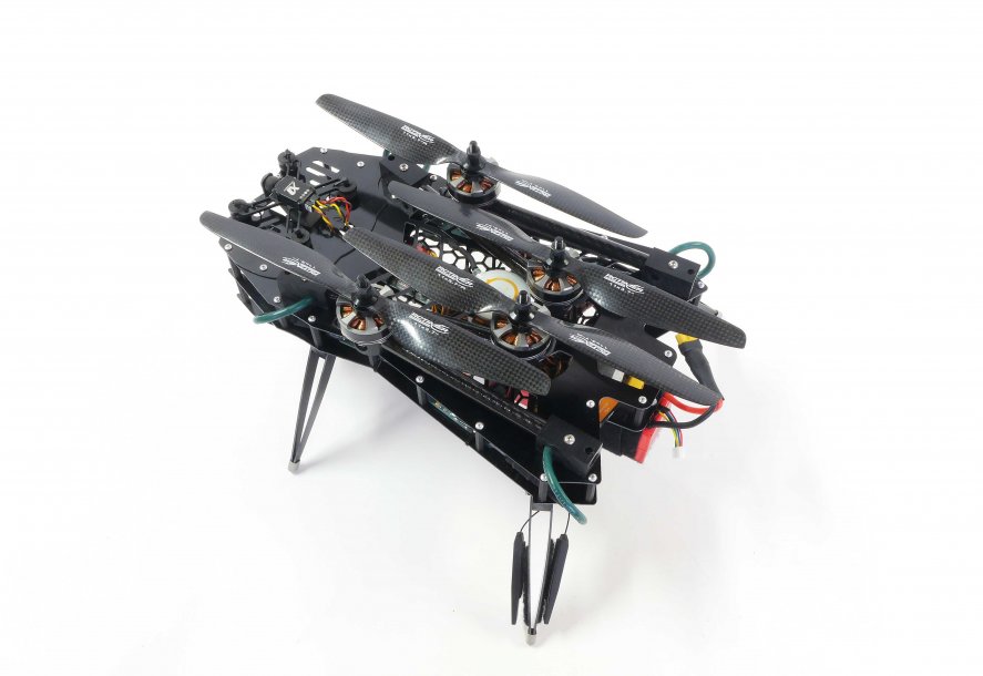

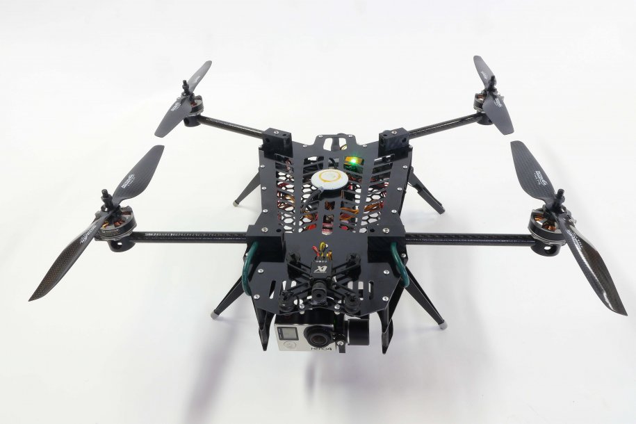

here you go, gents
I dig how pretty much everything is tucked inside and protected.
even the motors are virtually protected - arms will collapse both ways if hit hard enough because they sit on top instead of being sandwiched between frame members. And when they do collapse the props aren't cutting up your wiring or slicing through your gps.
