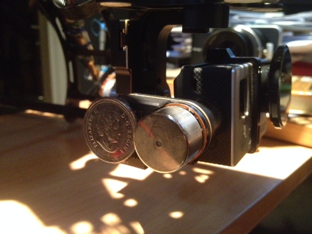

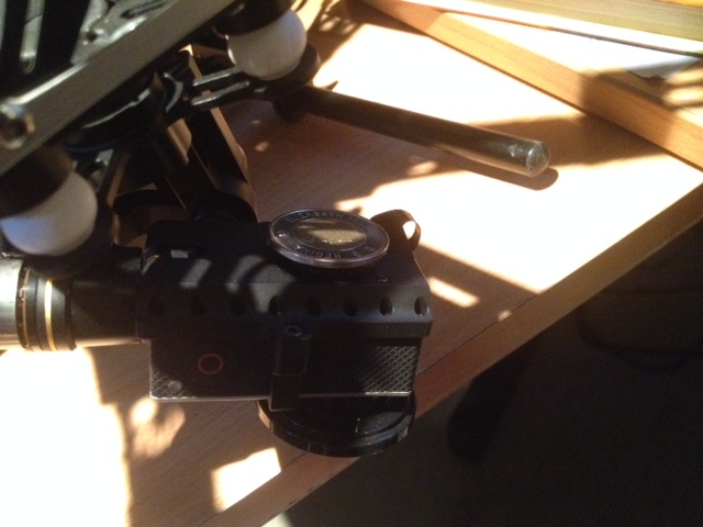

Check these out. Polar Pro makes them. They work great. Counter balance the gimbal (I use coins with velcro) One on the back of the H3-3D gimbal and another just behind the tilt motor. When not using the filters remove the coins. Counterbalance with gimbal off. The idea is it should remain upright facing forward and reasonably level. I use Canadian currency—Toonie and a quarter.
Good luck.
