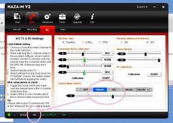

I am having trouble with setting my control mode switch on my F450 with DJI V2.
I am currently running the quad using my Spectrum DX7 and setting the 3 way Flap switch GPS - ALTITUDE - FAILSAFE.
My problem is when I am switching between the the different modes the blue box highlights which one I am on however at the bottom of the screen the text indicates something different (see screen shot).
Can anyone confirm which one is correct.
Thanks.
Thanks.
