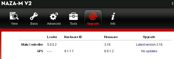

I'm tyring to help out a friend with a F550 with a Naza M GPS V1.
After upgrading to firmware 3.16 in the upgrade tab we get the following
And after doing all the calibrations the F550 will not arm.
Any suggestion would be greatly appreciated

Have you verified the travel/range for all your controls and confirmed you can get full range on all of them?
What LED indications are you getting?
BTW, your version page looks good to me.

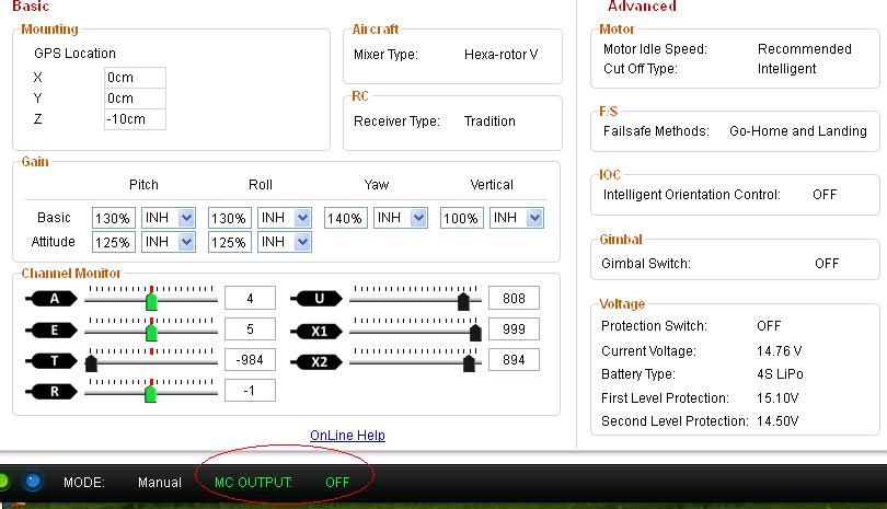

photobobga
Make sure the controllers are not reversed. The stick movements for the throttle and elevator are the most challenging. When moving these controls forward the software should show the arrow traveling to the right. Once that is confirmed, be sure and do an Advanced IMU Calibration and a Command Stick Calibrate.

If it was just an upgrade I assume that all your Tx settings are the same so don't change them, the problem is elsewhere.
You need to go through and re-run all the calibrations and re-calibrate your GPS.

I have one other question, Are you able to arm the system when it is connected to the usb
I'll run through all the calibrations again and retest

Yes you can still arm the Naza but no the motors should not start as long as it says "MC Output off" in the assistant software but still a good/safe idea to take all the props off. Hope that's what you were asking about?
