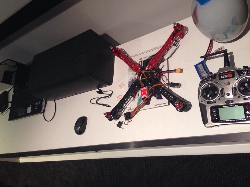

Any reason my motors won't start? Could be something stupid all channels show as working fine on the assistant View attachment 13768

I may be way off base here but from your picture it looks like your radio isn't turned on.
did you move both sticks down and out or any one of the crazy csc moves in the naza manual?
CdA D
A little more info please. Have you flown this quad before? Do you get an arming tone when you power the ESC's? Are the trims in your Tx set to 0?
RobertsUp
Your photo shows your craft equipped with the stock Dji esc's. The problem is probably in how your DX8 is set up. Try again arming the motors with those csc stick positions.
rceight6
Squared it away thanks guys, something to do with a switch set to reverse on Tx but normal on the Naza fiddled around with it and managed to arm it. Cheers for taking the time to respond anyway guys
