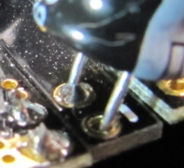

Bad solder job. Back in the air. Shaun
Here's one I fixed yesterday. The solder should flow through the hole and leave a fillet on each leg. The cap leg soldering on an MK distribution board and BLC is extremely important. In a worst case, a bad joint will bring the craft down AND fry every microchip on the I2C bus.
Do yourself a favor and check every joint.
