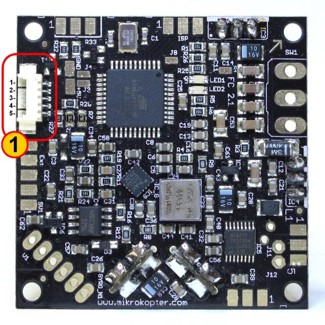

Hi guys
Does anyone know where I can get a 5 pin molex connector for the FC2.1ME board as I will be using I2C-PWM convertor by timecop?

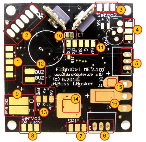

Back again Craig; So to confirm if I have things correct.
I solder wires from pins C & D also the earth pin to the I2C-PWM board???
View attachment 1543View attachment 1544
Looking at thew last photo of the underside; I can solder direct to connector No.9 ( C & D )?
Ross
View attachment 2637View attachment 2638
Ross
Im going to do the same thing and im going to use the molex cable as it give a clean look and you wont have any wires hanging out of the bottom of the board Tom
http://shop.quadrocopter.us/Molex-Cable-for-FC-21-and-GPS_p_109.html
http://www.mikrokopter.de/ucwiki/FlightCtrl_ME_2_1
Ross
Ross,
I just soldered wires to the C & D pads which connect to the C & D pins on the converter board. Mine go via a plug
As for the ground, I just get my power and ground from the FC to the Converter board. I know in the manual it says to connect C, D and ground to the Converter board pins, but the ground pins on the converter board are connected so if you are powering the board from an external power source you are connecting a ground to it anyway. Thats how I have mine setup.
Hope this helps,
Cheers,
Craig

anaka
Hi guys, i'd like to move the gps module esternally like in the cinestar configuration, for this i need to build a custon long cable so I cant and don't want to change the molex
does anyone knows the correct name of the stock molex connector present in the gps module?
I know I can also buy one from Quadcopter.com but they are in USA and I live in Europe so is too much expensive
thanks
Augusto

Hi Dave, thanks for your attention..i know mikrokpter world by several years :D
what i need is a different version of this cable, I need at least 15 centimeters long cable version and it looks that only quadrocopter has it
does anyone knows another european place where to buy it? or at least the exact name of the molex connector?
i can quickly rebuild it but have to buy the right components
