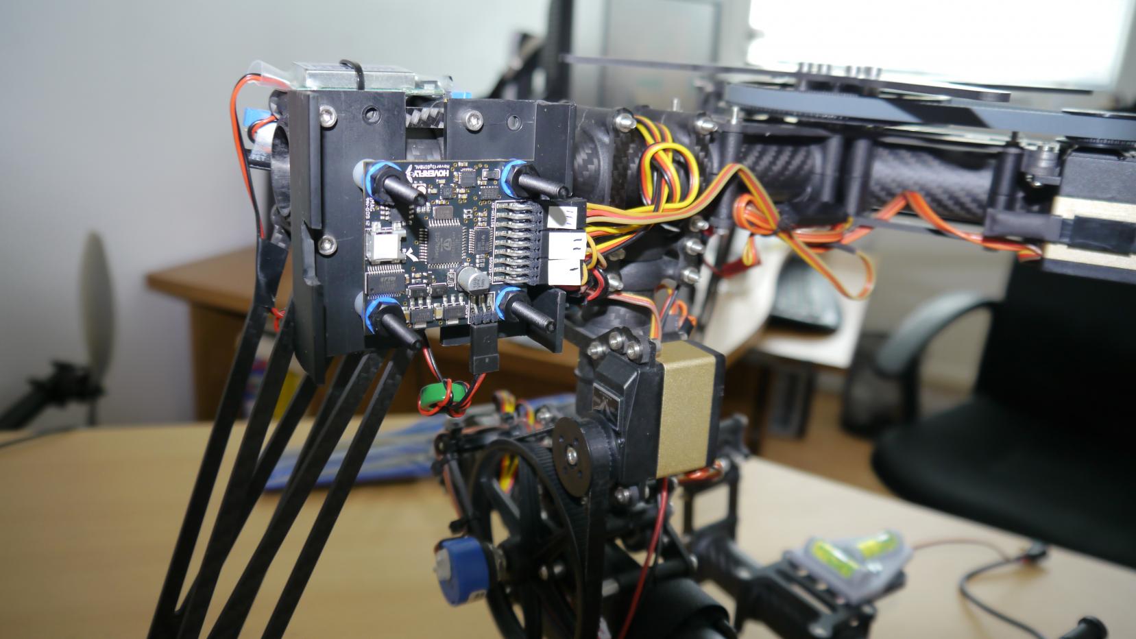

Try repeating the calibrations. I have not seen this problem with 1.01. Also check where your HoverflyGIMBAL is mounted. If there is anything that can create magnetic interference moving near the board it can cause problems. An example would be a servo that moves back and forth near the board.
osiris
I did recalibrate the board few times already but will give it another try later. Regarding the servos there is one (for roll, as seen on the image) about 6cm off the edge of the board but is stationary relative to the board. No servo on the gimbal is moving relatively to the HF board.
