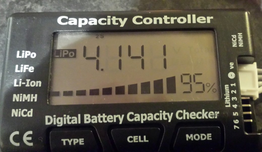

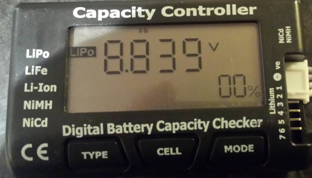

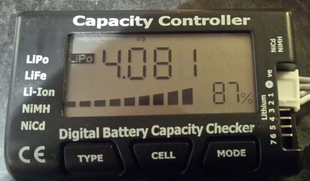

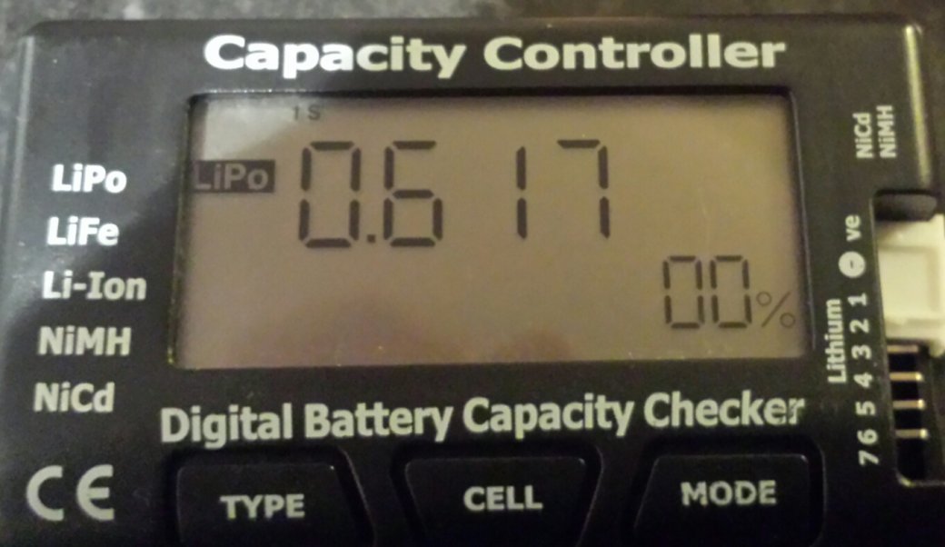

I tested the battery and 1 cell is completely dead whilst the other 2 remain almost fully charged, which indicates to me a battery failure.
Sadly I think your storage of the Lipo's has done the damage I'm sorry to have to inform you.
Lipo's should be stored with approx 50%-60% charge (no more) not fully charged. Storing them fully charged damages their chemistry. Basically the chemistry degrades if left fully charged.
There are many good articles on Lipo battery care & management, I think there is a sticky on this forum just haven't the time to find it for you, but Google will turn up many articles on this subject
Carapau
Im with the others on this I'm afraid. Poor storage conditions have malkied the cell in my opinion.
